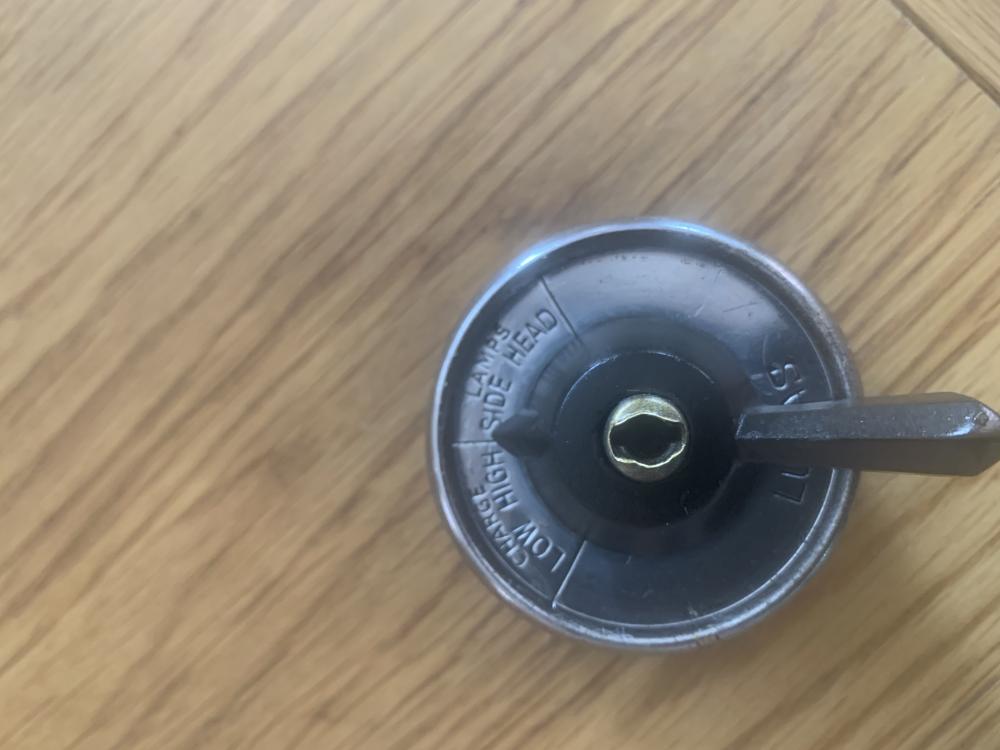

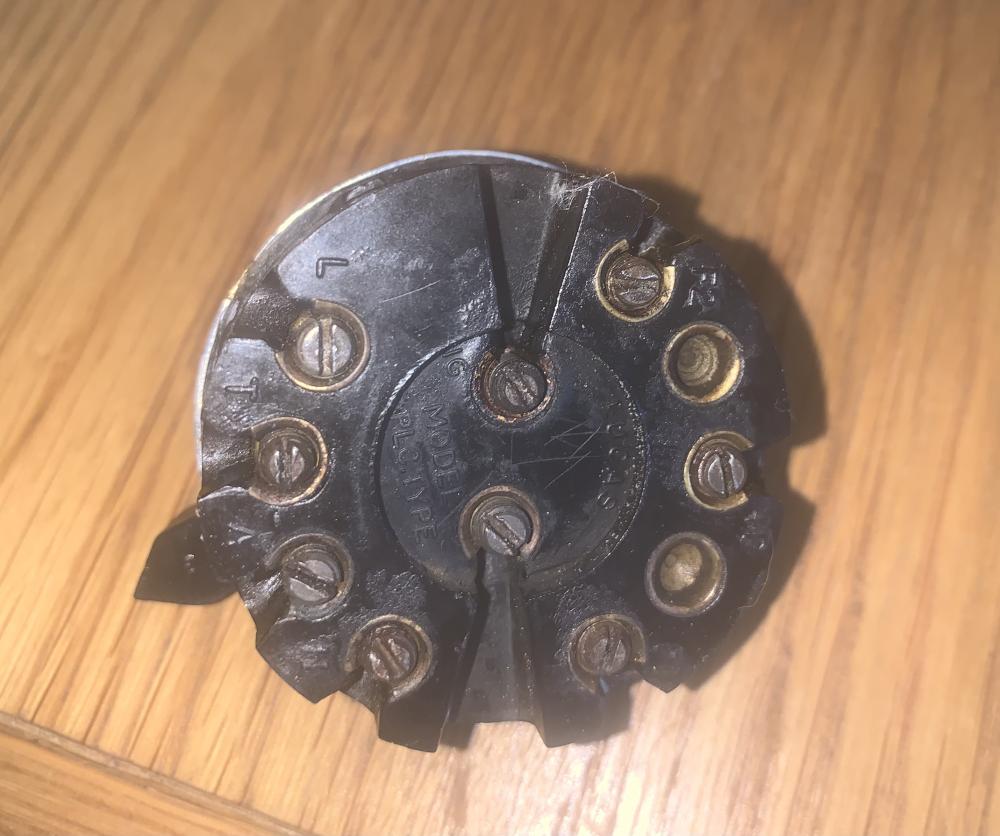

Just a word of warning. Unless you like complicated reassembly problems, don't attempt to take the Lucas PLC switch apart, but if you do, do it in a plastic bag. It will do an impression of the "Big Bang" .
#25
I’ve done it already
Strong hands and heavy duty plastic bag required

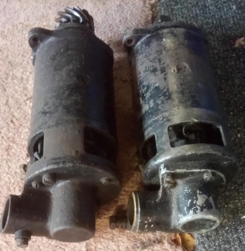

As I have been sorting Autojumble for the centenary event, for the sake of completeness, here are the two CAV DEL dynamos together:
The long armature is on the left and the short armature right. You may be able to make out the cylindrical case on the short armature is fabricated from two parts as well as the fabricated end cap. Production engineering was in its infancy in the late 1920's but someone worked out it was a lot cheaper to produce the later machine no doubt.

Thank you for that very clear Master Class in recognising and dating dynamos

(13-07-2022, 10:15 AM)Parazine Wrote: As I have been sorting Autojumble for the centenary event, for the sake of completeness, here are the two CAV DEL dynamos together:
Hi Parazine
Does the two part case mean you can inspect and remove the distributor drive gear without disturbing the brushes?
#29
Great info
Mine is a short armature
Many thanks
I’m looking to swap mine for a good / recon latest dynamo if anyone is interested
#30
Hmm good question. It's a few years since I stripped and rebuilt one of these but as I remember it, the dismantling procedure was different to the C35A/M variants that we are all more familiar with. I think removal of the smaller end casing reveals the drive gear but what was entailed in that removal, I can't remember off hand!
