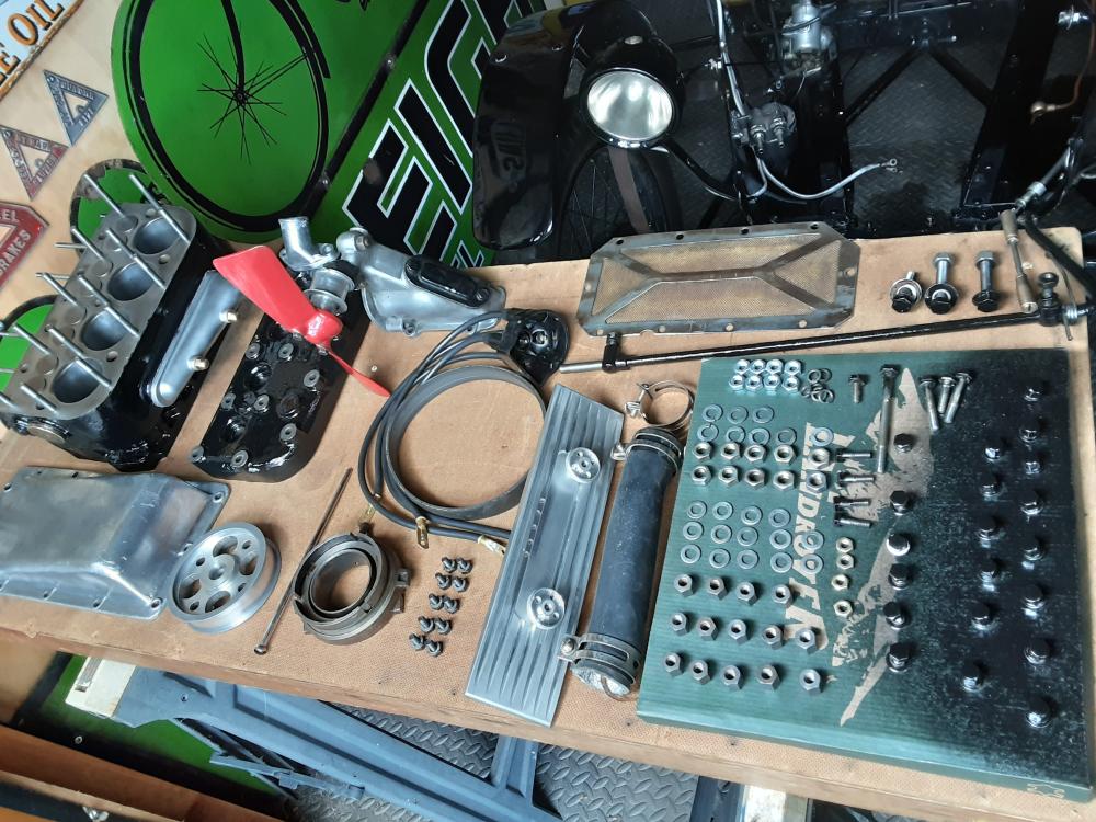

Pushing on with this build.
The carb has been rebuilt, BUT the bottom half is only on loan.
My original just had 30 stamped.
I now have a 30 mov bottom half that is going out tomorrow to be checked and rebuilt.
In the meantime, the pile of parts that have been worked on. Or even just cleaned and painted, are starting to pile up.
if I can dodge the phone next week. A couple of days of cleaning and painting, should see the engine starting to go back together.

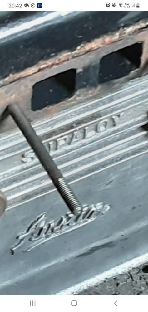

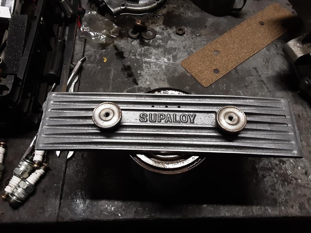

This is the old superloy valve chest cover. That was fitted. (In a hurry last time I went round sealing leaks).
Here is the new cover and knurled knobs I get made myself.
I'll be fitting these because they dont have any manufacturers Mark's, like superloy.
I've also filed of the part numbers from the seven workshops side water manifold.
Nothing against the seven workshop OR MYSELF. I just dont want after market markings on the engine.

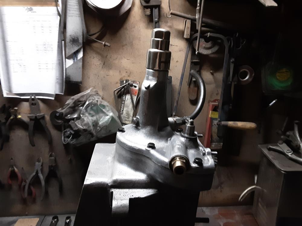

Well, I now have a pile of mainly restored parts.
The repaired nosecone came back, yesterday morning.
The old steel lip seal had been spinning in the housing for a long time. And the result was it had warn the housing enough that a new seal would not hold.
So the housing has been sleeved, and a smaller o/d lip seal fitted.
