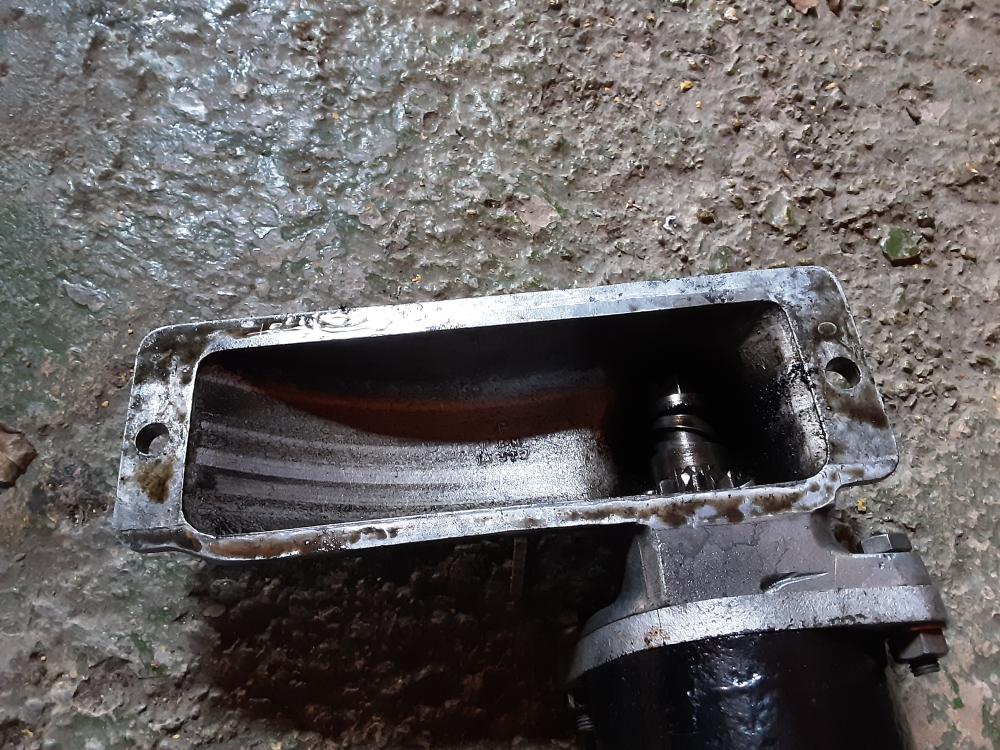

Plenty of oil on the starter, although I have NO clutch slip?
Losing plenty of oil under the car, on sump. And dripping down chassis.

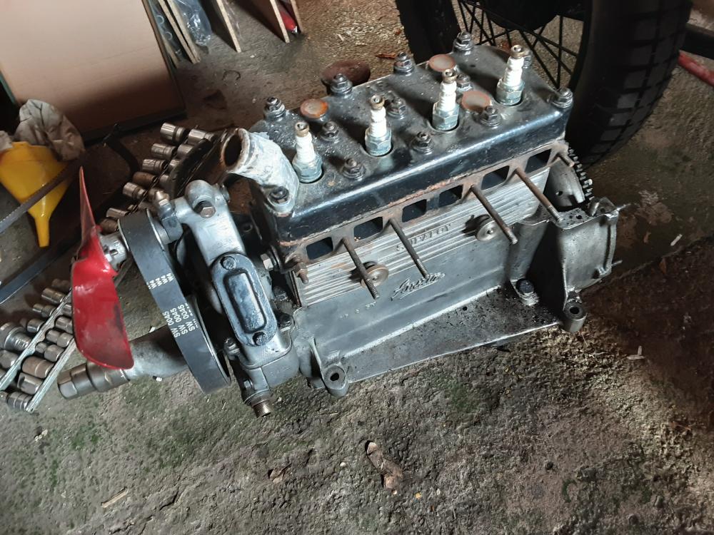

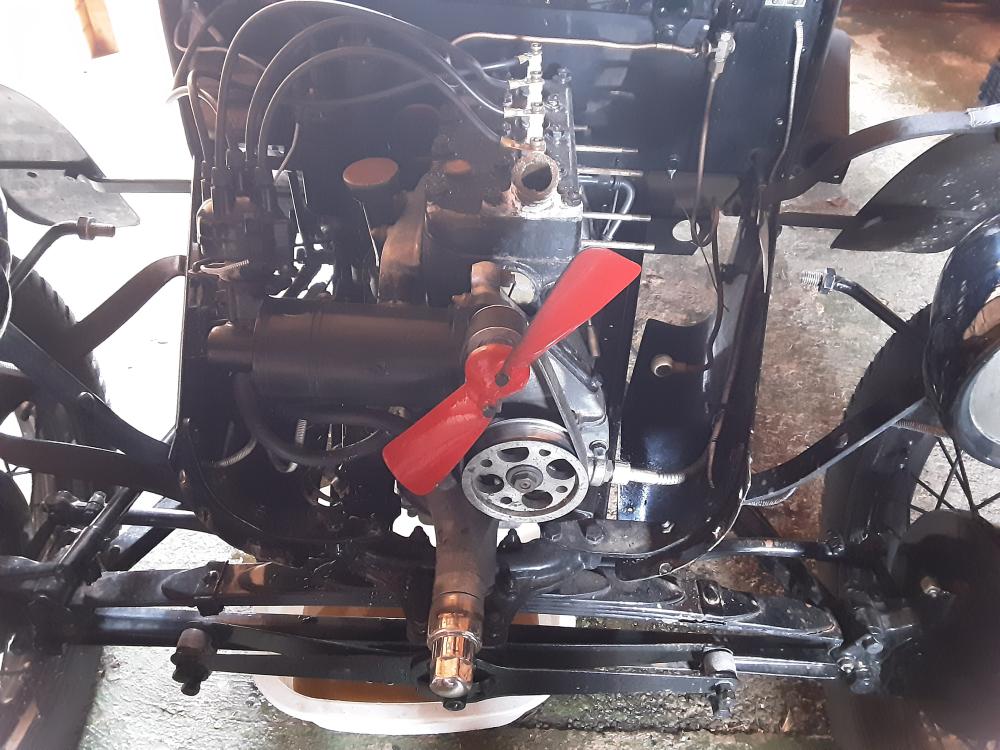

Engine out.
Alot of oil around the engine bay.

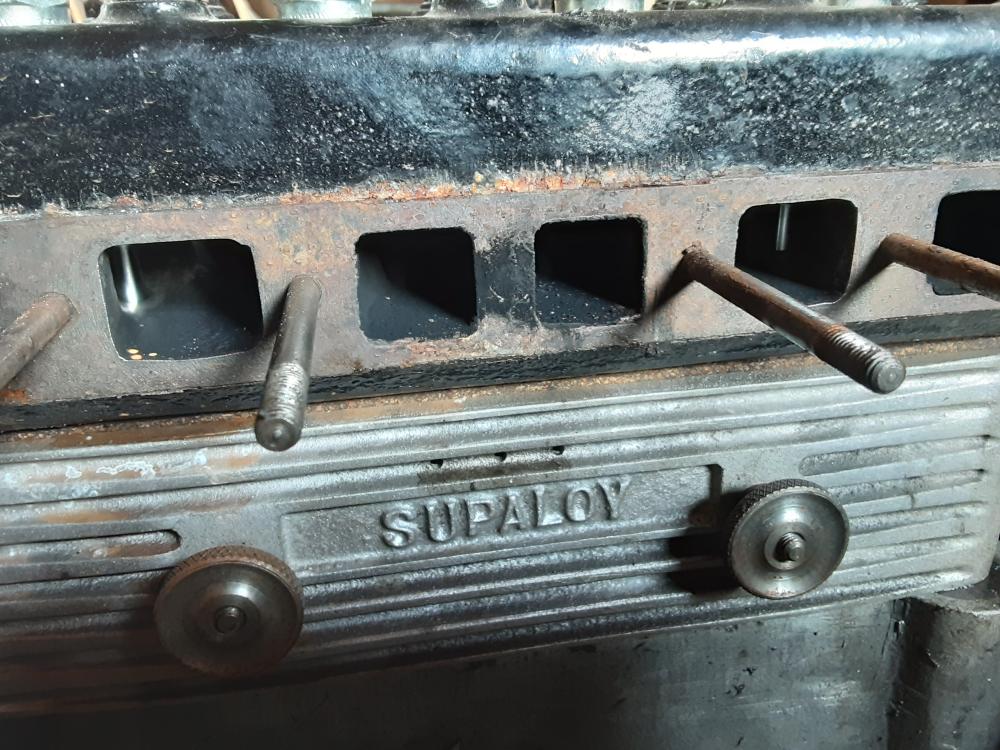

The exhaust is a 3 into 1. So centre stud is cut off.
The exhaust is blowing between 2 and 3 exhaust port.

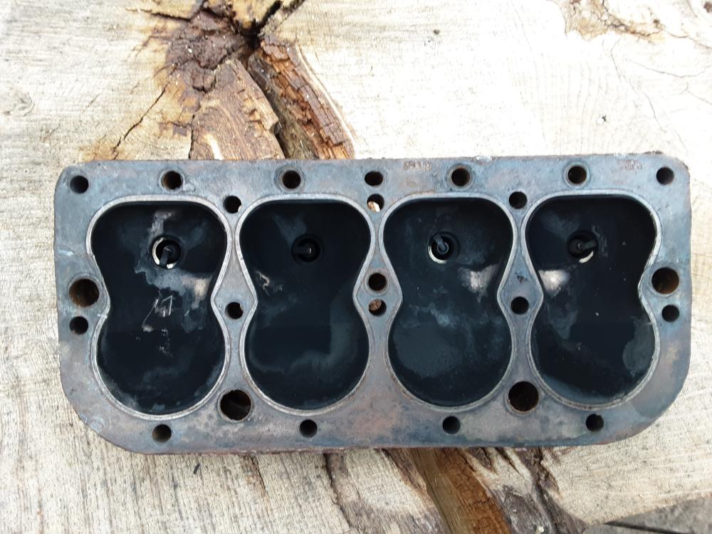

Removed the head.
The seal on the gasket is stunningly good.

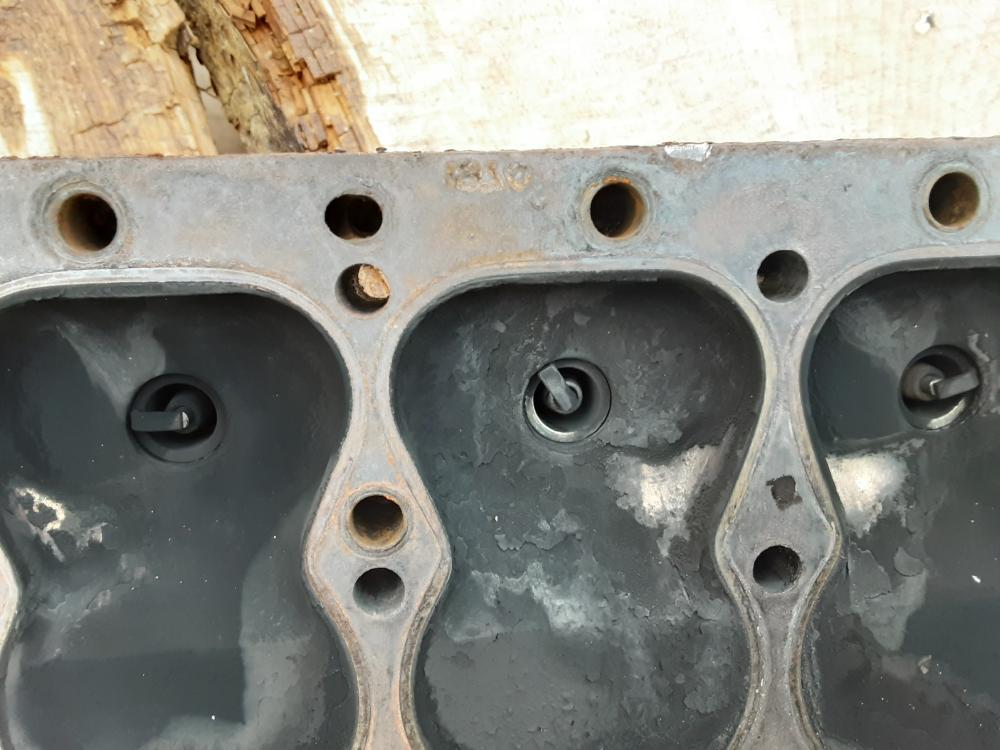

But check the NEW spark plugs, 3 are parcially sooted. And 1 is fully sooted. They have only been in for 15 miles.
Also check the white patches over the inlet valves, but only in 3 cylinders.
Dont worry about the head gasket, I'll be putting a new one on Big Grin
But also check the whitening around the inlet valve.

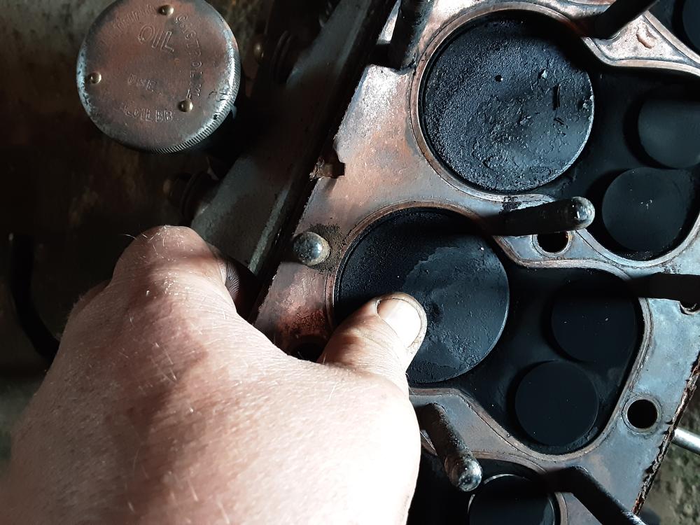

I've tried to show the slop. It's around 30 thou. And should be around 10 thou.
Also after checking the bores. Number 3 cylinder is starting to get two grooves from the gudgeon pin.
This could be part of the progressive problem.
I dont know if the pics will show the sideways movement in the pistons.
However, they are standard pistons.

the current pistons are standard, but as you can see the bores are baggy.

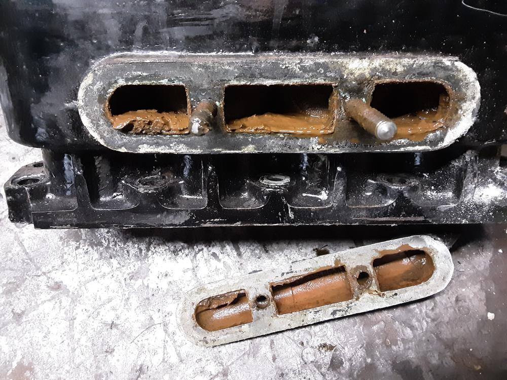

The water jacket had the usual crude build up.

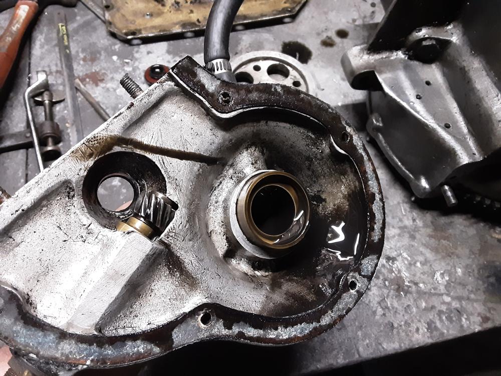

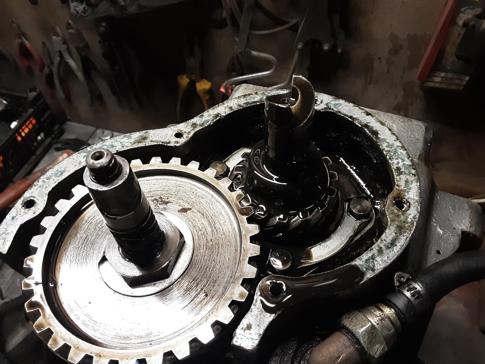

I needed to remove the nosecone to see why oil was being forced up the rev counter cable.
Theres plenty of oil everywhere.

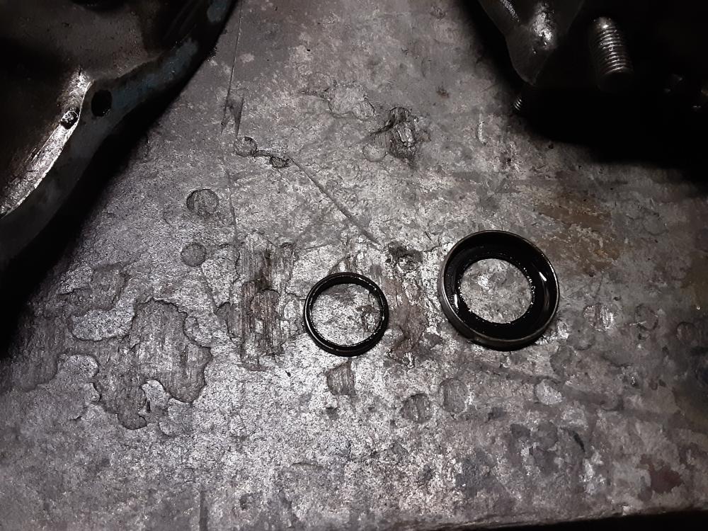

Then I found this.
The seal round the starter dog has broken in 2.
These are the rubbery bits in the sump, and showing on my finger.
And it will be the reason why the nosecone was filling with oil, and being forced up the rev counter cable.

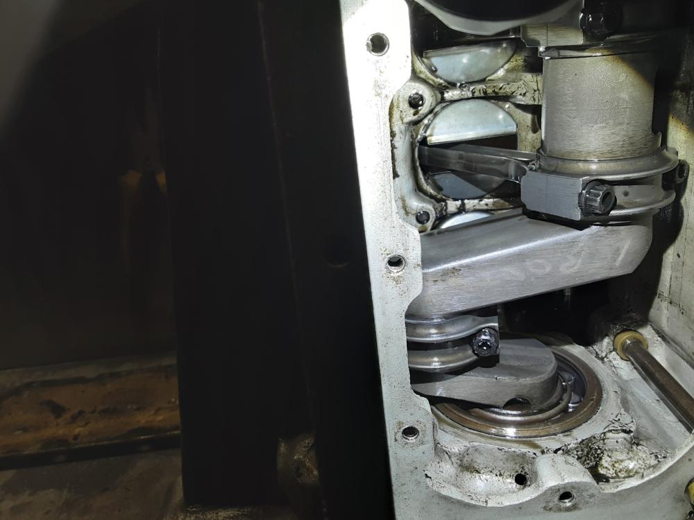

I've checked the big ends for play.
1, 2, 3, are fine, 4 has a small amount of play.
I'll see how bad it is when I remove the rods.
