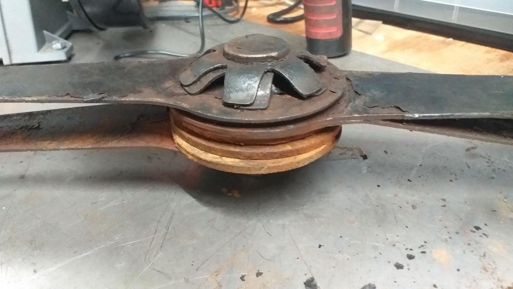

With more time on my hands between bouts of home schooling and gardening I've felt the need to disappear to the garage on a regular basis and thought I'd tackle the overhaul of the front shockabsorber.
Originally I was inclined to replace with a double arm unit, however after reading previous comments it seams the advantages of this unit are limited?
However, dyou can see from the photos the unit is quite rusty, in your opinion is it serviceable or should I replace and if so to what?

Not rusty by my standards.
The assembly doesn't look right, and I haven't seen the spider spring doubled like that before.
Maybe the guy who fitted the twin spider spring got fed up with them breaking, I must have binned dozens of broken ones. I've refurbished rustier ones than that with the aid of various rust removing fluids.
There should not be two disc surfaces in contact. It is not ideal if the rubbing surfaces are very pitted, esp if uisng expensive discs. I vaguely recall the Big Seven has a thin brass disc held in place by being punched into indentations in three or so spots. Could possibly revive with somesuh, using steel for cheapness.
Brass discs were fitted to Rubys too.
Brass discs were only fitted to the rear shock absorbers. Late Ruby and Big Seven.
Ah yes, Henry, rears only - but all Rubys, not just late models.
