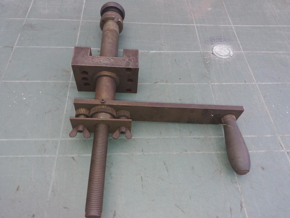

(08-12-2018, 12:57 PM)Ruairidh Dunford Wrote: On the wall of my father's workshop is a hand operated boring bar that a man in the village made to re-bore his Austin during the war.
It is beautifully made but we reckon it would take a day a bore!
My father writes:
"Here are photographs of an Austin Seven cylinder boring tool made during the war at The Bristol Aeroplane Company by the father of a friend of mine in Frampton.
It was made to bypass the wartime problems for private A7 owners.
I was shown how it worked 40 years ago and the only memory I have is of exhaustion."
#26
I wonder what bit of a Bristol plane those gears came from Ruairidh? Any slop in that bearing will produce a bore tapered the opposite way to normal.

Nicely constructed, but doubt if it improved the block as I cannot see how it would have produced
a parallel bore.
#29
Does the cone on the end locate the bottom of the bore as a guide ?
#30
As noted above - it was last turned around 40 years ago Dave, but yes, I think you are quite correct.
The man who designed and made it was able to make it work successfully, which has always impressed me.
