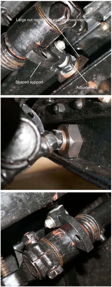

Although more work, it's not necessary to drill the cross member. Providing you can make something to wrap around the brake cross-shaft hanger and register against the bottom flange of the cross member (and a screw thread to make the necessary setting) it becomes a removable mod. Even on the coupled braked cars, this is still a worthwhile thing to do. The pictures below show one way of doing it.

Hi Jon
On the near side, yes.  On the off side it “hooks” the brake cross shaft and stops it moving backwards.
In reality they provide additional support to the cross shaft brackets. These are quite weak and as Jim says, can flex.

(25-08-2021, 05:14 PM)AustinWood Wrote: A similar one at the near side would prevent the bracket moving back.
watching underneath while someone presses the brake pedal is interesting. The movement on the brackets is surprising!
I have exactly that arrangement  Smile.
I like the idea of a "pull" bracket on the near-side. Can you say exactly which pipe brackets you used?

I used a much cruder bracket to stop the shaft moving back.
Made from a modified exhaust clamp.
Jim

Nick's drawing shows the bolt resting against the bracket. Would this not be better than resting against the cross-tube?
