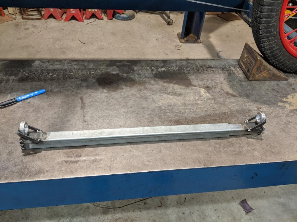

As I must have too much time on my hands and some scrap metal I decided to make a clamp and it works a treat.
RE: Drag link play - Ivor Hawkins - 04-12-2019
As they would say in Cornwall...proper job!
RE: Drag link play - Reckless Rat - 04-12-2019
Cushty. Pot au feu, Rodney.
RE: Drag link play - Zetomagneto - 05-12-2019
Go to the top of the class Mark, well done, looks a good bit of kit
