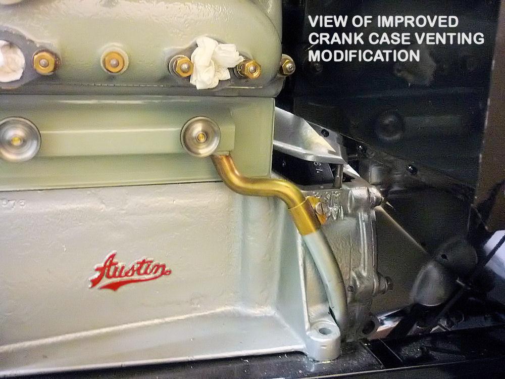

What possibly helped me, was to ensure that the crankcase was able to breathe (pipe connected to the oil filler tube that leads away to the side of the car) this seemed to take the pressure away from the modern lip seal/speedy sleeve arrangement (no oil thrower) and reduce oil leaking from the bell housing drain hole.
I checked for run out of the flywheel boss, less than 0.001", getting in to check concentricity of boss and seal is somewhat difficult. The engine has a crankcase vent to the air intake giving a depression of 3/4" water gauge.
Since crankcase ventilation of engines such as ours are so important, I modified my side cover with a chamber and pipe to road draft the fumes under the rear of the bell housing. It has yet to be tested but I'm confident it should work well.
