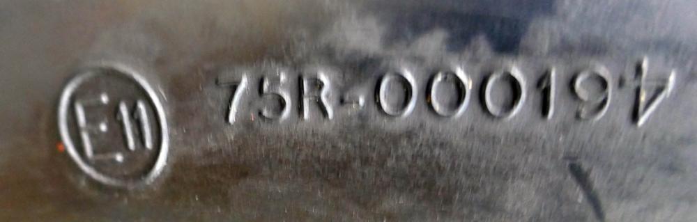

Might these markings - from one of four identical Avon sidecar tyres - show that it was made in the 1970s?
Tony, the date code is week (2 digits) then year (2 digits).
Before 2000 it was week (2 digits) then the final digit of the year (- fairly obvious why they changed to 4 digits).
So, that would make it the 7th week of 1970 - which, if correct, would be when I fitted them.
Chris KC, Your advice re tyre age and insurance judgement is worth consideration and armed with the info on this thread I shall investigate the Avons on my car. They could be as old as my children and they older than half the government ministers we now have.
Tony
I think yours are 7th week of 2000
