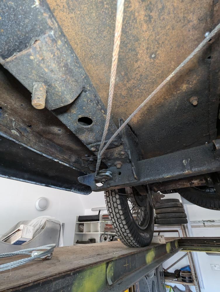

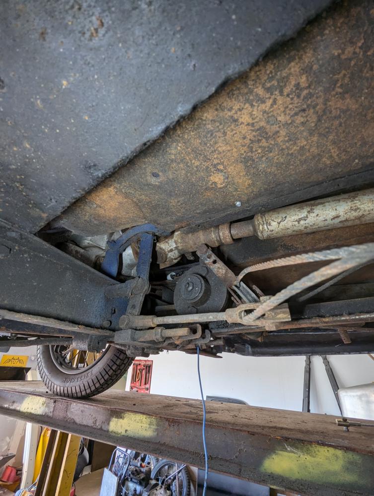

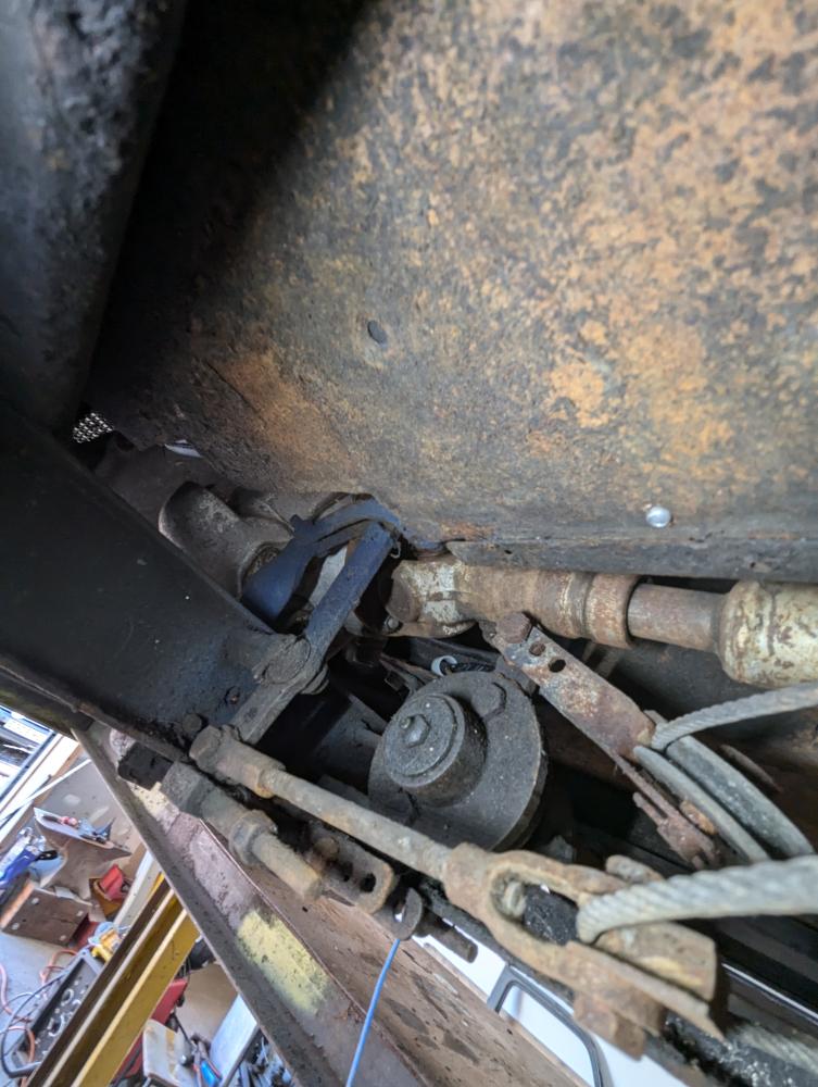

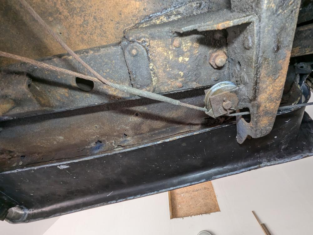

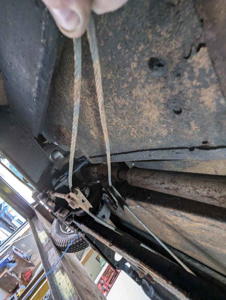

Here are some photographs of the set up - hopefully it explains if not I can do a drawing to help.

Crikey! I’ve seen some brake set ups on Sevens over the years, but that beats the lot!
Cables shouldn’t be a problem as Martin has pointed out.
I think I would call in the local piano tuner to set that lot up!
It never ceases to amaze me the ingenious solutions that enthusiasts have come up with to address problems in the past.   A great deal of time and thought has been put into this particular set up.
