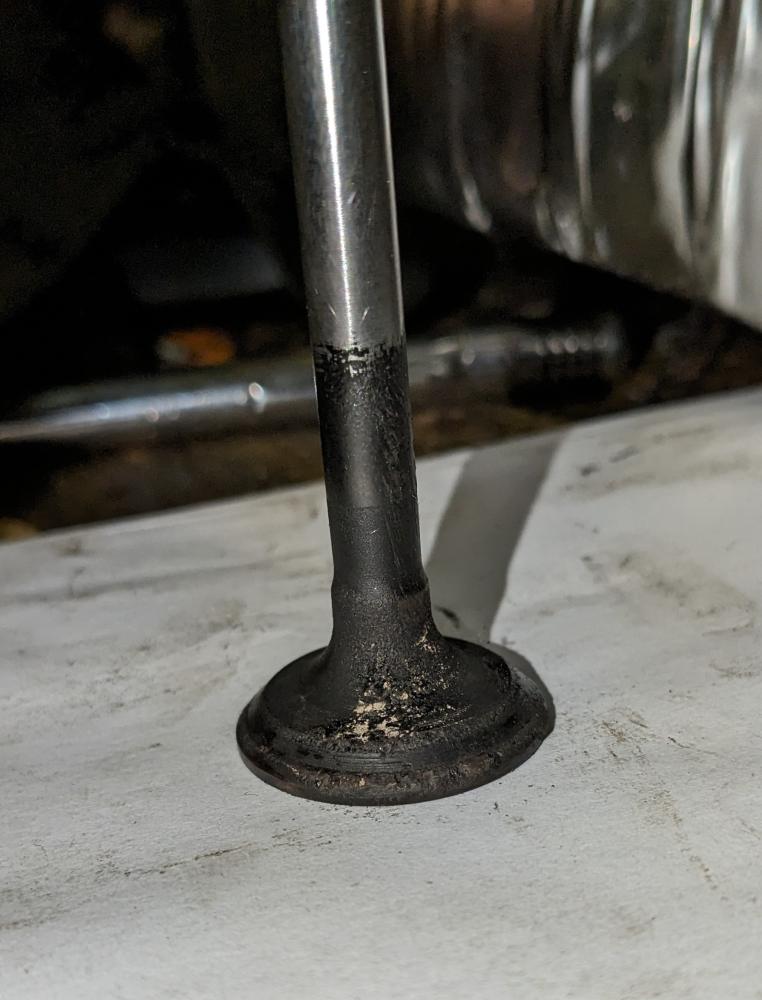

The engine started easily and ran well untill it was warm. It then lost power and started misfiring and running very rough. This was eventually traced to a sticking exhaust valve. This has happened before and was a built up of carbon on the stem.
Cleaning and grinding valves improved things but the engine had a very bad flat spot. Opening the accelerator had no immediate effect but after a delay it was OK. It was spitting back as well. I took this to be weak mixture. That would also explain the sticking exhaust valve.

The plugs in the engine were NGKs and I can't remember when they were fitted, but within the last 30,000 miles. No 3 plug was fouling so I tried some KLGs that have been around for ages (KLG wentout of business in 1958 I believe) which were much the same. We invested in new Champion D21s. The cause was actually the sticking No3 exhaust valve.
