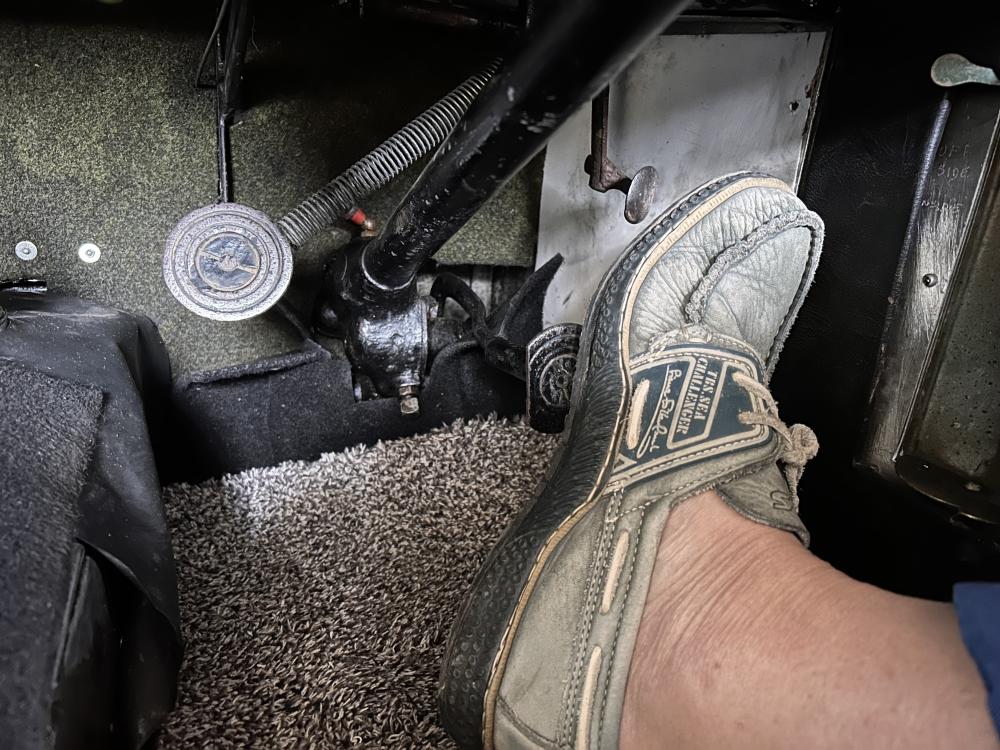

Here's a photo of the standard arrangement
.jpg   footwell.jpg (Size: 37.41 KB / Downloads: 346)
On my Ulsteroid I arranged the pedals to be placed very similarly to the standard arrangement, quite like the layout in Dave's picture. My brake and clutch pedals are standard, but the layout in your car looks different and less satisfactory, as you have found. I suggest that if your pedals are modified you should change back to standard type (I may be able to provide, but would need to check stock).
That’s very handy information! Many thanks, I’ll look deeper. Meanwhile Robert, please let me know if you have a set of pedals and pricing?
An under bonnet photo of throttle operation might be interesting, it currently looks not only wholly unoriginal, but not easy to imagine how the carb is operated. Is it an original Zenith? The brake has already had the slice taken off it, currently 180 degree out. My feet being size 11, I can’t drive a Seven wearing ordinary shoes. I have driving shoes with a much slimmer sole and thus ample clearance between pedals. Mine started their career as competition cycling shoes, slim enough to slip into rat trap pedals.

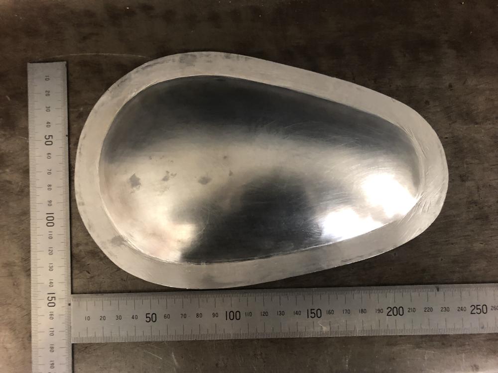

I am often asked to make blisters for chaps with larger feet/shoes and if your pedal set up is as you want it to be, fit a blister.
