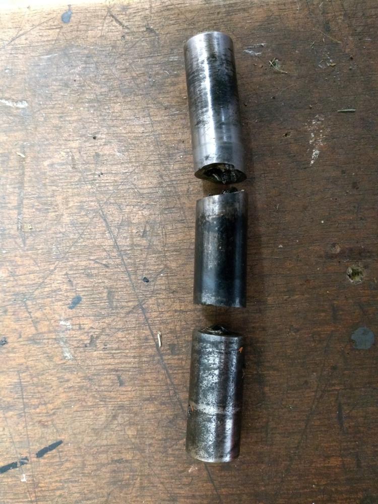

Broken kingpin
An unwelcome explanation of my wandery steering ... and I was hoping it was just a flat tyre!
A batch of king pins were incorrectly hardened some 20 years ago, or more. If from that it has done well to last to date. Replace both sides with new.

With it fractured in two places lucky no to lose a wheel. How did it get so rusty? Can hardly be greased too often. Pins of Oz Dufor manufacture have poor reputation here. Poweful brakes not entirely a blessing. The bits more securely retained with the pre Girling hubs.
More of a case of using the wrong steel. Most likely En8 was used as when hardened due to the carbon content hardens through and makes it very brittle. Welding it has similar results the heat draws the carbon to the joint and produces a week weld.
Normally En32 or En 36 would be used, both case hardening steels.

That was my first thought that it was too brittle. No idea how old it was, a lot more than 20 years though.
I reckon the first break occurred 30 miles or so before the second - the steering became sufficiently vague that I stopped to check tyres and wheel nuts. Just before home the brakes started to affect the steering quite noticeably and I knew something was wrong. Thankfully both breaks were within the height of the axle eye so it all held together, just! No harm done.

(10-10-2021, 12:46 AM)Bob Culver Wrote: With it fractured in two places lucky no to lose a wheel. How did it get so rusty? Can hardly be greased too often. Pins of Oz Dufor manufacture have poor reputation here. Poweful brakes not entirely a blessing. The bits more securely retained with the pre Girling hubs.
The king pins rust because they are greased with a grease that is not waterproof. I raised this on the old forum years ago but got shot down in flames.
Use a grease that is waterproof, i.e. a calcium based grease, used to be Castrol CL but others have to be found now that Castrol have run away from the market. Lithium based grease forms an emulsion with water, leading to the damage (but not the breakage!) in the photo. I know we all have our favourite greases, oils and whatever but using a waterproof grease on the exposed chassis parts will stop the rusting illustrated.

P.S. tried silver steel kingpins years ago, when the debacle of overhardened, 10 thou undersize, tapered kingpins was running. They broke within 500 miles.

Ruiradh's right about the origins of those king pins but more like 40 years ago than 20. Time flies when you're having fun!!
