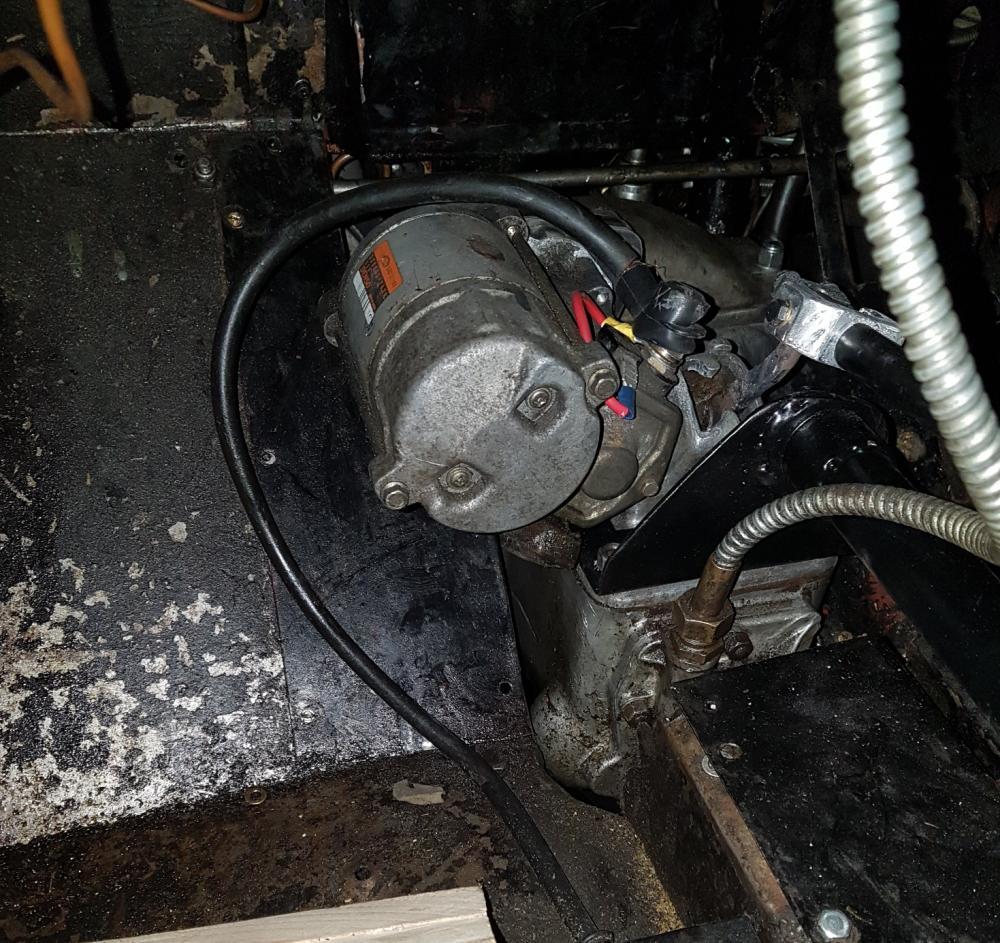

I've used a Rover 75 petrol V6 starter motor with a change of pinion on my 3 speed box. I suspect that if you fitted it 180 degrees rotated from my set up you *might* get the clearance you need. With a target price of less than £10 it might be worth trying

Ideal but you do need to change the pinion and make a 10mm aluminium spacer plate.
I'll look out a source for the pinion and message you.
