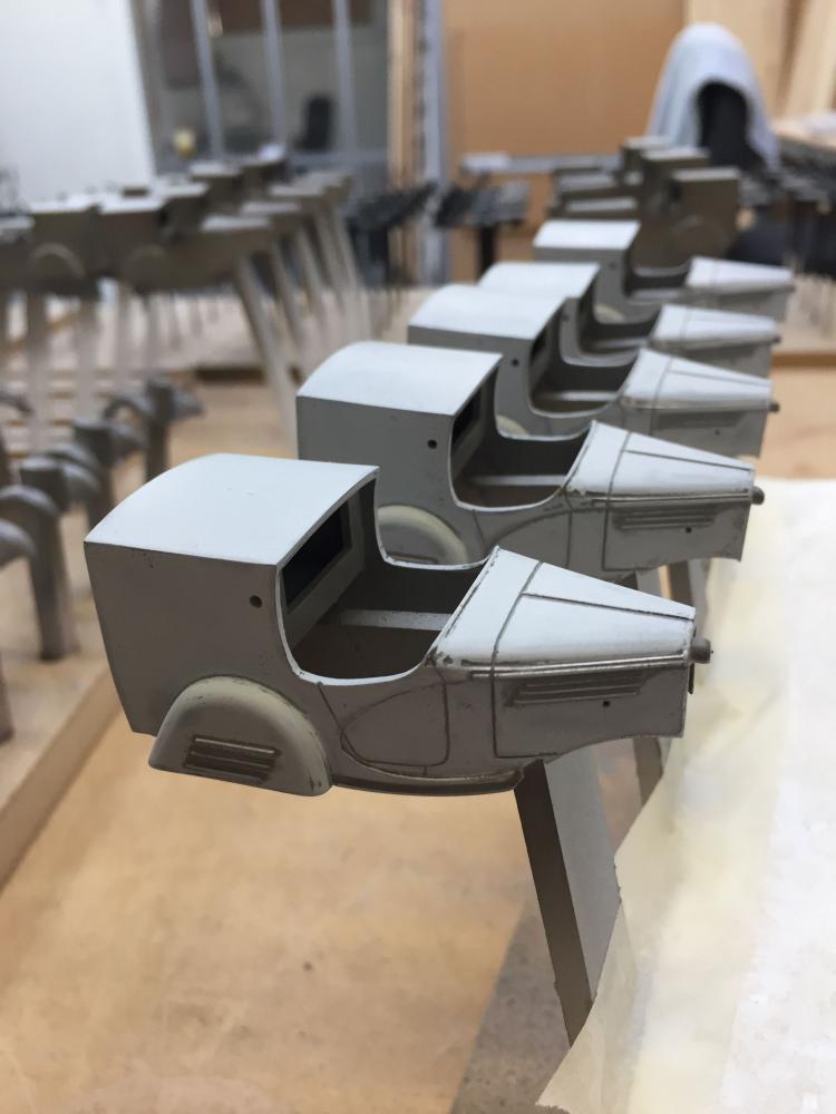

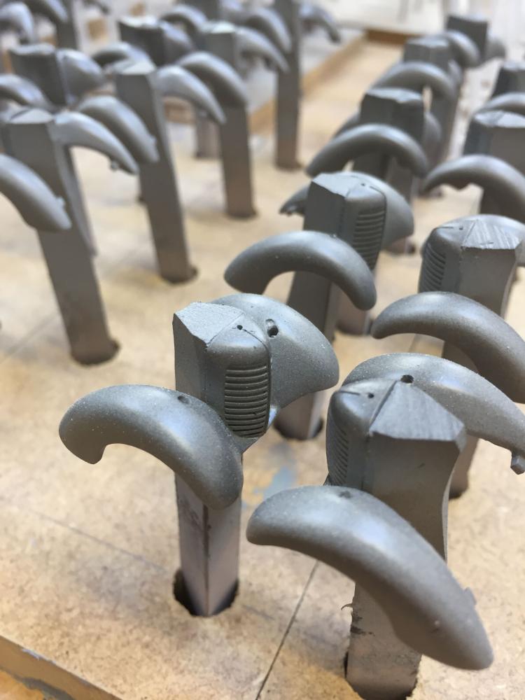

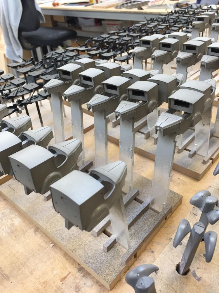

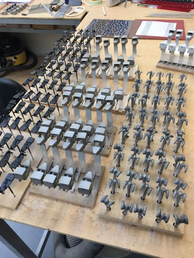

This is some fantastic work. Peter showed me some of the production pictures of the previous cars whilst on the Euro tour. I was very envious of him making things like this as a living. Try to get him to show some of his other work, not just card.
His work is stunning Derek - I am glad you met him.
Impressive! What is the material?
Erich
I think it is white metal Erich - Peter does follow the Forum so hopefully he will correct me if I am wrong.
Thank you for posting those Ruairidh.
Erich, they are indeed white metal, with brass etched details on the chassis. They are at the primer stage at the moment - you'll see some have had the guide coat rubbed down in preparation for spraying the final colour.
