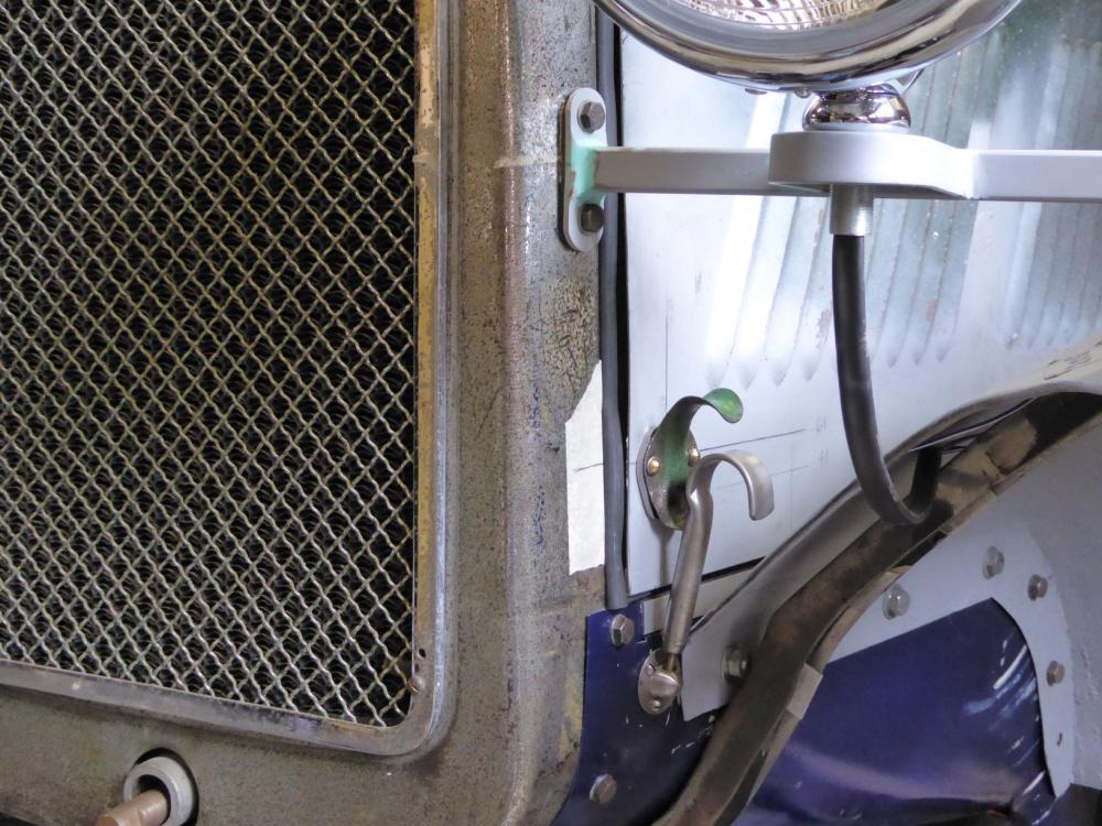

I have decided to use standard A7 bonnet handles (two each side) as shown at the bottom of this post.
.jpg   handle 1.jpg (Size: 127.35 KB / Downloads: 345)
Could anyone advise of a suitable sealant to use on the bonnet handles shown below? It will be applied between cellulose painted parts and the body and bonnet.
The front handle/catch arrangement (see below) has a plate under the bonnet mounted part - I think a removable (soft?) sealant here would be a good idea?
The plate is threaded and is used in part to secure the bonnet handle avoiding a hole too close to the edge of the bonnet and interfering with the radiator cowl.
The rear arrangement (see below) has a plate mounted on the body - again I think a removable (soft?) sealant here would be a good idea?

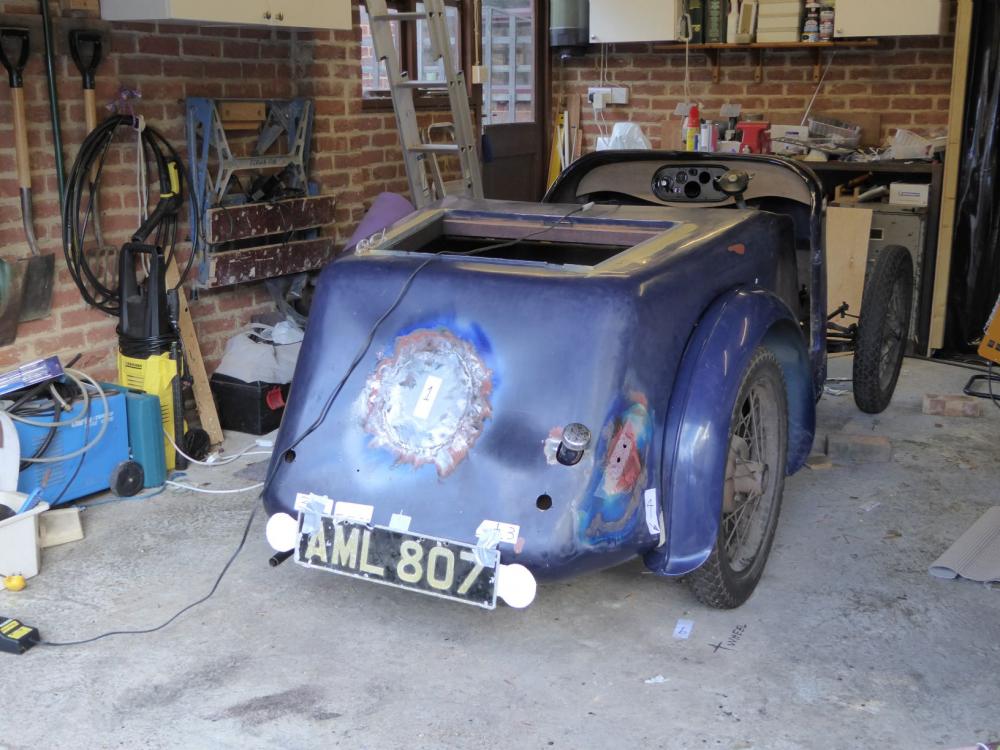

Re: Rear of car
This is a picture showing the rear end with carboard rear lights/number plate mounting...trying to work out the best way to do it before getting the rear of the car professionally restored. The car is now being restored and is looking good. I tried to insert more pictures but something is playing up.
Regards Peter
