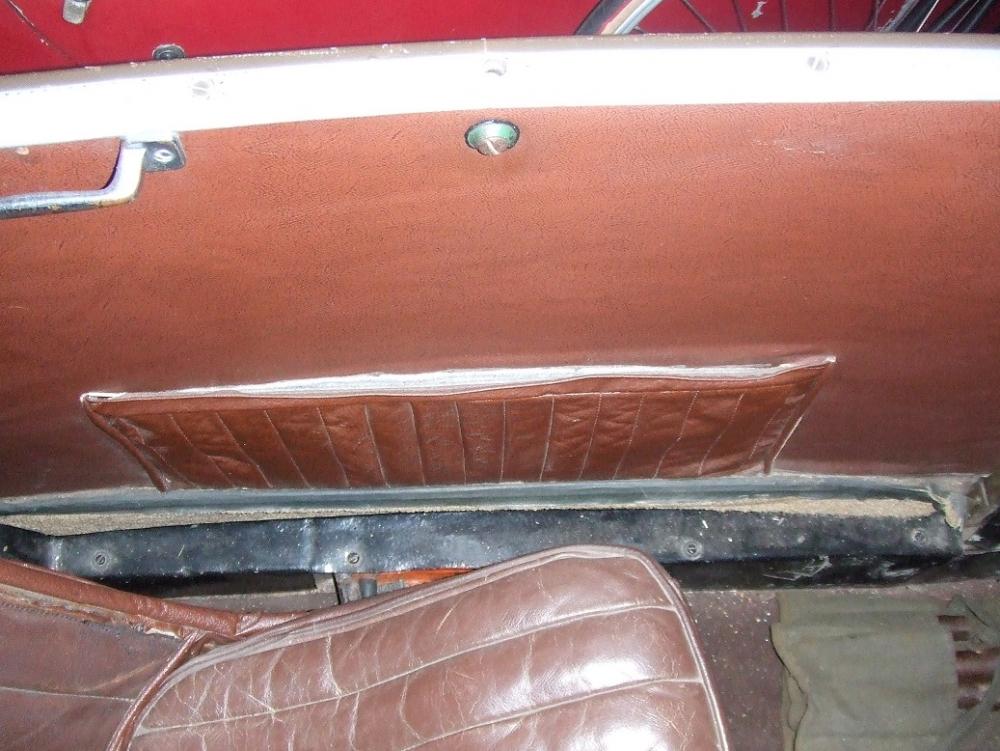

Martin, I have owned my 1933 4 seat tourer for over half a century and it has always had curved doors and curved "kick plates" to match. I've seen identical ones on other tourers.
Regards,
Stuart
PS the little horizontal cut near the front door pillar is not Sir Herbert's idea - nor, indeed, mine!
S.
.jpg   DSCF3856.JPG (Size: 158.89 KB / Downloads: 116)
From one in the Workshop just now.
(09-12-2018, 11:48 AM)stuartu Wrote: Martin, I have owned my 1933 4 seat tourer for over half a century and it has always had curved doors and curved "kick plates" to match. I've seen identical ones on other tourers.
Regards,
Stuart
S.
Very useful Stuart.  Are the door handles an original fitting?
