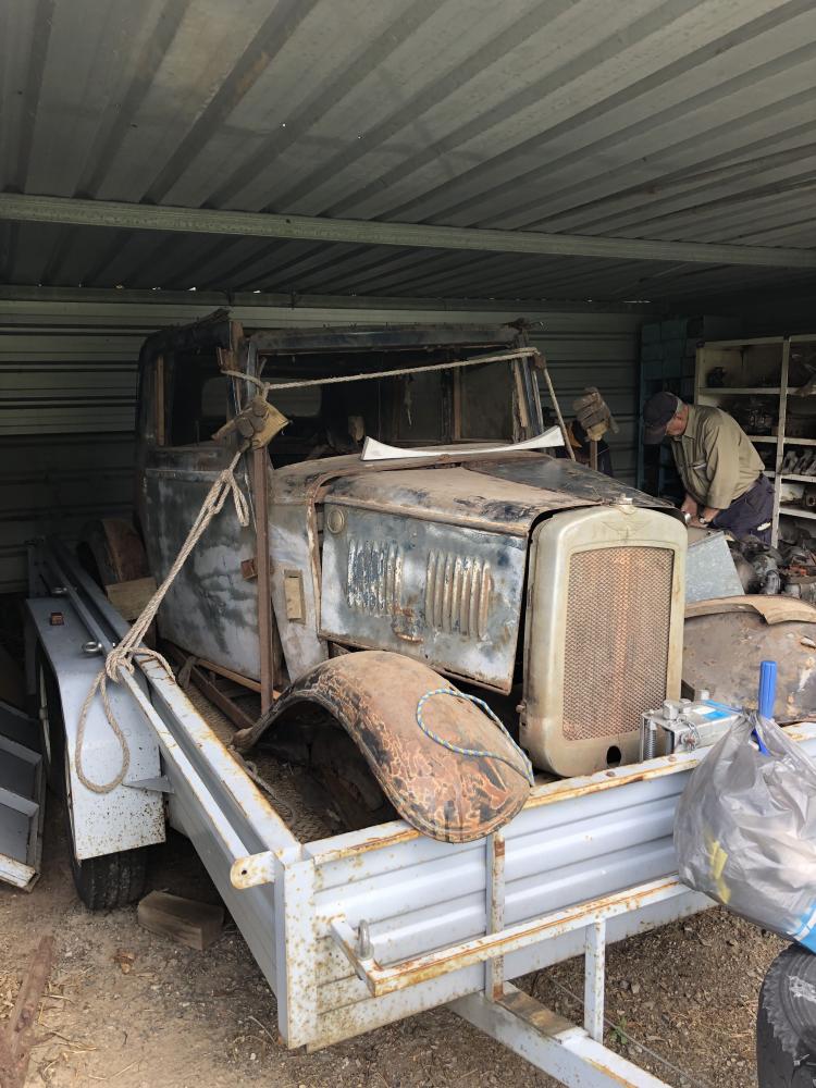

Just looking for any thoughts on wheel sizes from the learned out there.   My son and I are currently rebuilding a 1929 Hope bodied Austin (photo attached) in Australia with the intention of taking her on some endurance runs.  The first trip will have us going over a fair amount of gravel roads with some softish sand underfoot in some locations, it’s about endurance not speed.  We have six wheels all in varying states of disrepair and the intention is to have new rims pressed and of course new spokes fitted.  The current crownwheel / pinion is  a 8/42 and the available gear box is a 4 speed (not got in to the guts of that yet).
I understand A7’s had 16”, 17”, 18” and 19”wheels and I was planning on going larger with the idea being that a larger wheel is more rubber on the road, and better for cruising  but maybe that will make the slow speed stuff more difficult?
Any thoughts on the size of rim we should go for?
Thanks in advance

I would go for 19" wheels with 3.50 section tyres.  The car will look correct, 19" tyres are readily available and cheap, and they will cope well with any difficult ground.  The 5.25 axle ratio will be okay, especially with a 4-speed gearbox.  Looks like a good project and I am sure it will give you lots of fun on your planned adventures.

I also would go for 19", and for much the same reasons.
With my Nippy I use 19 inch for the trials ....3.50 front and larger rear.  Has had much success, but for road use at any speed the handling is a bit scarey.  16 inch (an Austin export size) I found very good for normal road use but tyres in that size became nearly impossible to get so had 15 inch built using Citrone 2CV rims on front (2CV tyres easy to get) and (I think) Peugot rims for rears (for extra but not too wide). Both had extra strong spokes.......these were built by a motorcycle wheel man who punched the rim holes properly.  I still use the 15s after many years and they are still as strong. So look for a motorcycle wheel man........my man was so much cheaper than car wheel firms.

A few questions if I may- are you sure your car is a 1930 as Squeak has questioned?  Are you sure your diff ratio is 5.25?  What is the wheelbase?
1930 models used 4.19 ratio, had a 6'3" wheelbase, and the fact also that you have a 4-speed g/box makes one wonder if your car isn't later with w/base 6'9" as Squeak has queried.   Cheers,  Bill in Oz
