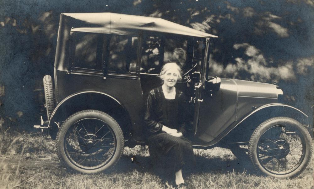

What about this one then ?
That’s not a Chummy Robert!   Big Grin
I don’t use anything between the items you mention Jboy - others will though.
I was waiting for someone to say that, but it is a in period photograph clearly showing wing piping!!
Now I’m confused!
It’s exactly what happens when trying to be definitive - there are always exceptions/alternatives etc.
I know that the Chummy shown in the photo was new at the time and has no piping, the Saloon appears to be the same and has piping.
Another period (factory??) shot of a Chummy here: http://www.austinsevenfriends.co.uk/foru...view&id=39
Over the years I have had several 'chummies' (1926-1930), and not one of them has had wing beading; and I have also had three RK saloons, which have all had beading! I would hesitate to make the logical conclusion, but ...
Oh, and Robert, what a fabulous photo - may I add it to the Gallery?
