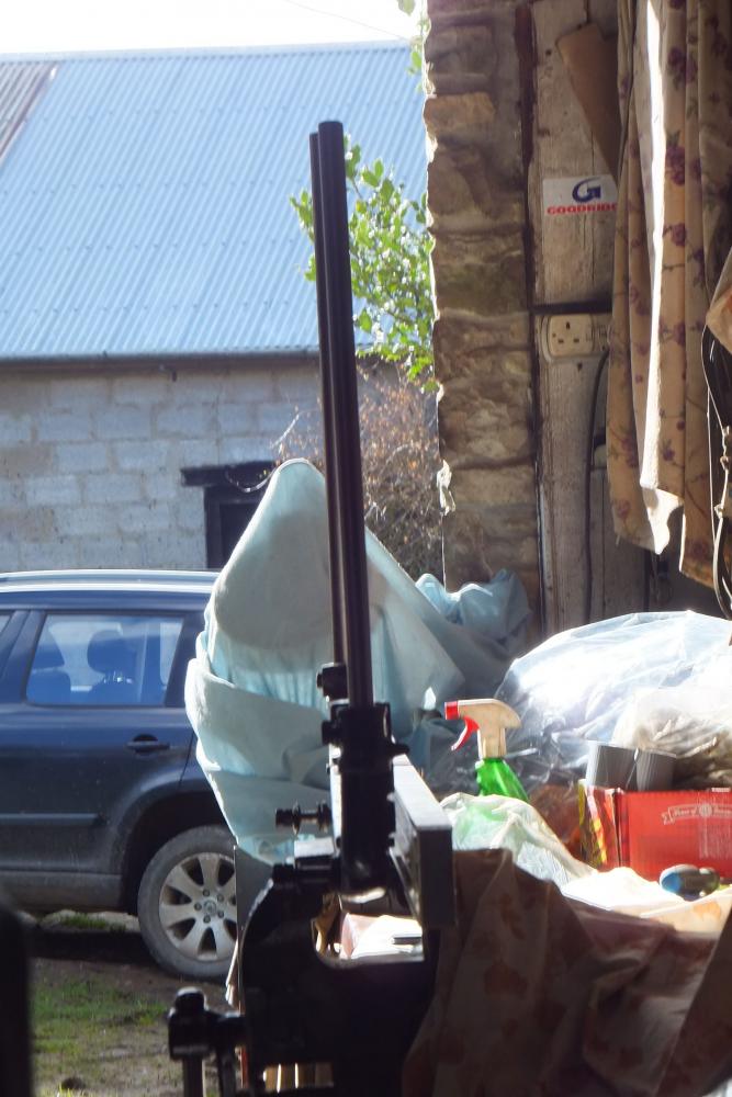

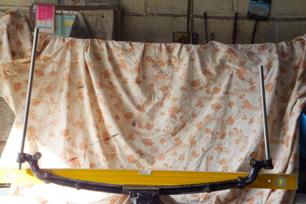

I am just checking my big 7 axle for alignment.  With 5/8" rods in the king pin eyes I noted that they were very slightly out of alignment......as also were the 1/2 inch bars vertically in the radius arm bolt holes., but 1/2" and 5/8" bars seemed in alignment at each end  I clamped the king pin eye at one end horizontally in the vice and using a Stilson with extended tube (motor bike fork tube) on the other end I mightily heaved to untwist (I nearly broke a rib when I pushed my body against the tube to assist the twisting!!). It is surprising just how bendy and elastic an axle is........however it must have done the job in the end and twisted just over the elastic limit as the bars are now as near as I can see in alignment, as can be seen in the photo below.
The next bit I notice is that the 'swivel pin' (king pin) angle certainly is not 0 deg. as per the Austin Journal for the normal 7 axle.  Using a protractor with spirit level attached I make the angle 82.5 degrees, inwards at the top on each side.
Does anyone have the info on the BIG 7 axle or know where I can find it.  I must assume that the angle of the stub axle will eventually give the correct CASTOR angle of the wheel.......we shall see. (I have an original old dunlop castor camber wheel aligning tool so should give old degree measurements instead of any modern fangled degrees  Rolleyes )
