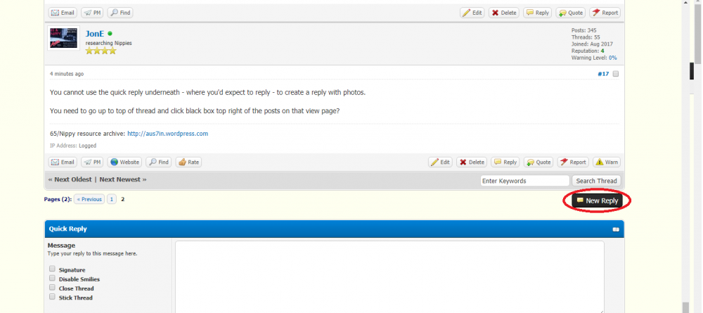

You cannot use the quick reply underneath - where you'd expect to reply - to create a reply with photos.
You need to go up to top of thread and click black box top right of the posts on that view page?
Joined: Aug 2017 Posts: 442 Threads: 52
8
Location: New Forest
Car type: 1928 Mulliner Fabric Saloon
Or, to save you scrolling up Jon, below the last post on that page on the right...
