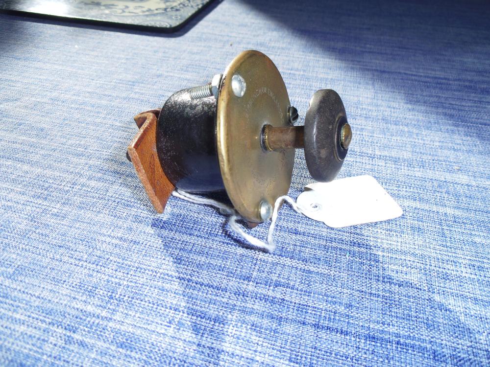

I have been looking for a floor starter button/switch and a seller with a spare has one. Just wanted to run this photo by you all. Is this the right kind of switch for my car?
Please let me know.
Also, can someone suggest a place for rebuilding the steering wheel and redoing the celluloid coating.
Thanks!
#63
From the photos on your post I can see that this switch is not the one you need, if you do a search on this forum for Floor Mounted Starter Switch, you can see the other type.

#64
Thanks Paul, got it.
