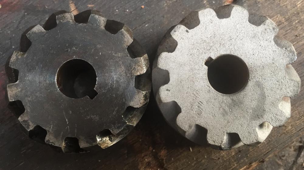

This resulted in a full strip down and timing gear replacement on Wednesday for me.  The crank gear was totally unmarked and this suggested top end cause.  I removed the gear from the end of the Dynamator and compared it carefully to an original.  The new gear has a much sharper profile and I am almost certain that this is the cause of the rapid wear.  The new gear is on the left of this photo.
I have now fitted new (2nd hand) timing gears and an original dynamo gear onto the end of the Dynamator, blued everything up and checked for correct backlash.  This new set up has covered a number of miles and shows no signs of any wear - I will continue to monitor this daily and report back if I find the same issue occurring.
I would strongly suggest that anyone who has a Dynamator fitted check to see if the gear is causing wear, I would also encourage those people to change the new gear for an original one.

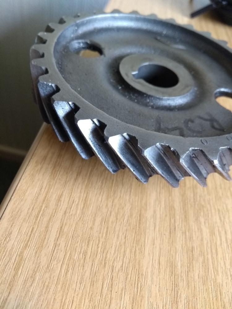

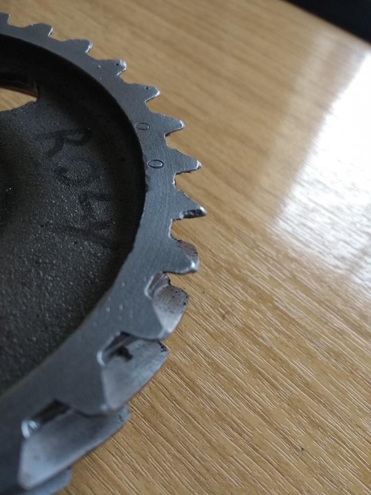

I too have suffered this experience, the Dynamator had been used for about 200 miles. First two pictures.

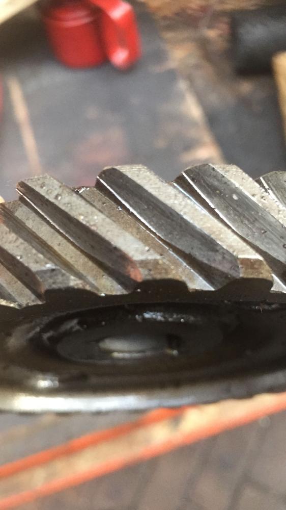

Another owner in our Hereford Austin Seven Club also found the same issue when I asked him to inspect his timing gear. His Dynamator had also been used for about 200 miles. Third picture.

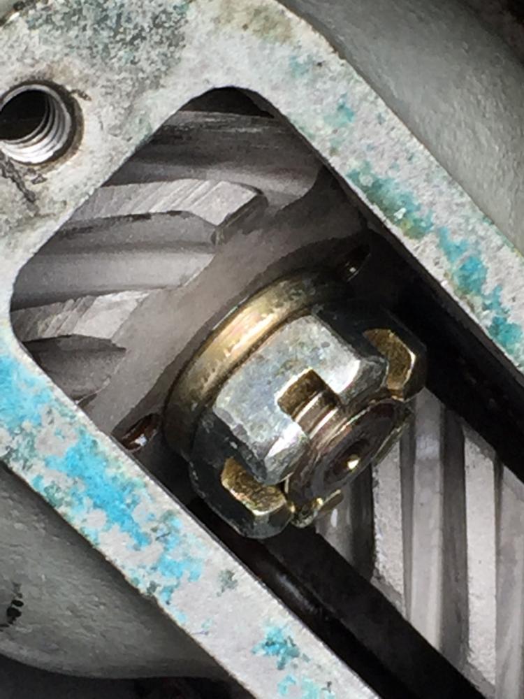

These are the gears I fitted, on Wednesday, after about 50 miles of use.
There is a little reflection from oil residue, after I cleaned them for the photo, but no new wear marks.  I will keep posting with updates and hopefully all will still be well.
