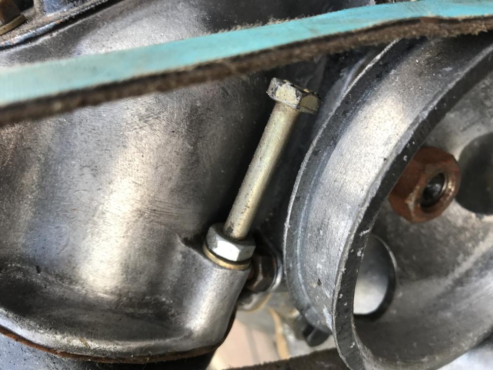

(29-01-2024, 11:00 AM)Ruairidh Dunford Wrote: Long bolts, with a nut wound down to the point where the original bolt head would have been, stick out beyond the casing and allow a spanner to be used without difficulty.
I like that thinking but on a mag engined car the “bulge” of the dynamo housing gets in the way.
On my car for reasons of my go faster modification, it's a real pain/impossibility to do the rear dynamo housing nut up onto the stud. I made a short barrel nut and brazed the end of a socket head screw onto the top. Now it’s manageable
