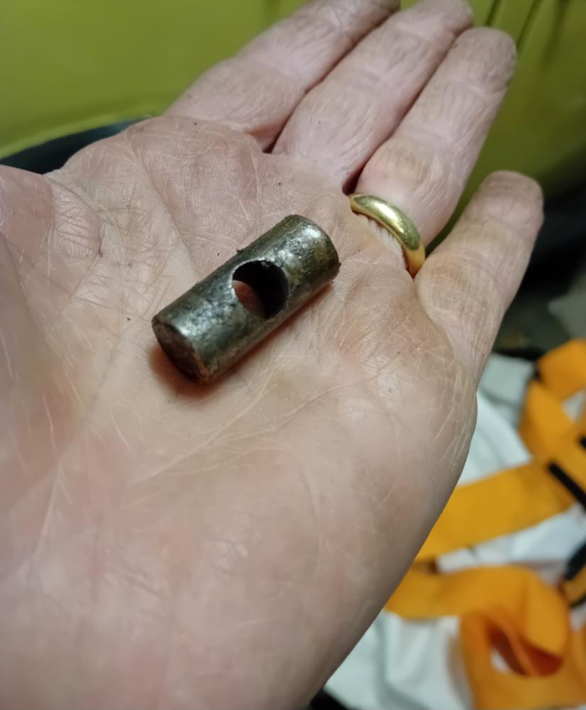

If I knew what it was called I could probably order one
Question
But I don't, so I can't!
Can someone please tell me what the short piece of ½" bar with a hole drilled centrally (it fits in a fork in the cross shaft) that swivels and allows adjustment of the brake pedal is called? I need one for the handbrake on my special.
It's known as a 'Barrel nut', Nick.
Quit easy to make  if you've got a pillar drill. (use a vee block for accuracy).
Bob
Not to be confused with the whiffle tree that goes in front of it….
(15-01-2024, 04:49 PM)Bob Kneale Wrote: It's known as a 'Barrel nut', Nick.
Bob
Thanks Bob... very useful, and if push comes to shove one might work, but this little fellow is not threaded.
Brake Lever Swivel Pin
I don't think the pin is available separately - just the BK68c assembly here:
www.a7c.co.uk/spares.php#brakes
Bob
No - not a barrel nut as far as I can see  Huh
Chris's Brake Lever Swivel Pin sounds more like it  Rolleyes
Is it BN 23 that goes with Brake Adjusting Rod BN 8 or BN 45
I'd call that a trunnion.
Suffolk, UK
1925 Chummy
1934 Box
Hi Nick,
There are two items that share very similar properties to the one you photograph.
One has a threaded hole with a flat machined on the rear - this item holds the wiffle tree bracket for the front brakes.
The other is drilled plain and has the curved finish on both sides of the hole, it holds the brake pedal rod and the adjustment wing nut steady on the end of the brake cross shaft bracket.
They are often mixed up in rebuilds because the length and diameter are the same.
My guess is that you have the one intended fir the brake pedal rod.
