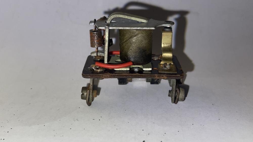

I am missing the much of the charging circuit, and it seems to have been replaced with a later relay, unless I am mistaken. I have decided to rewire the whole car rather than risk starting a fire and as I am also colourblind I am  using my own choice of wires. Sorry to any purists! Using 14/0.3 1mm wire for the basic rear light circuits (indicators, and single stop & brake above the number plate. Running separate earth wires to each as I am keeping the 6v system. I haven’t got to the other circuits yet though!

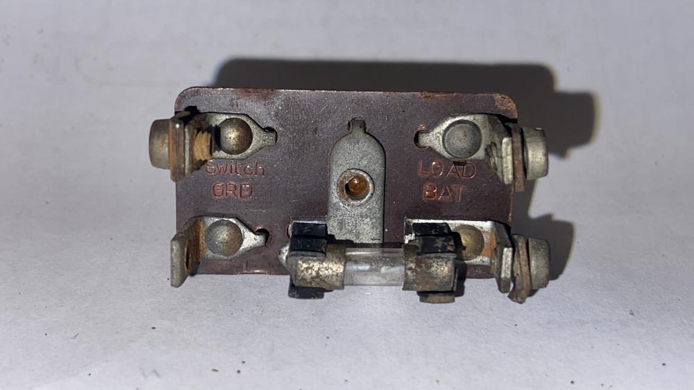

I wonder who BN was who decided to scratch his initials and date into the back of the main switch panel, or does it represent something else?
#83
As far as I'm aware 'BN' is the Lucas code for components destined for Austin vehicles - Morris for example was 'A' possibly because they may have been their first major car manufacturing customer. I believe other car manufacturers using Lucas equipment were similarly given one or two letter codes. I can't remember the code for Wolseley though I do have a Wolseley engine so will check the Lucas dynamo, starter and distributor which should all carry the code.

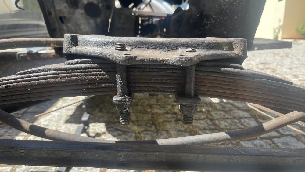

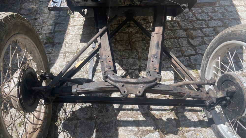

This front spring hanger mechanism looks rather odd! Someone has gone to the trouble of tapping the front frame, as far as I can tell. It certainly doesn’t look right to me!

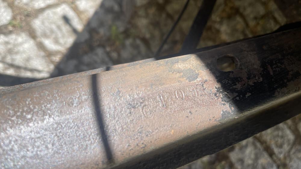

Nice to find the chassis number is still there though!
#85

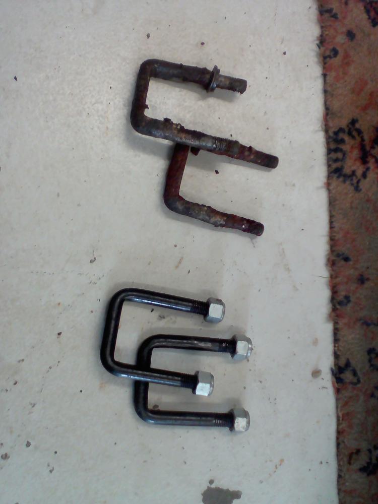

Looks like someone has made their own spring U bolts up. They should be a bent piece of rod in a U shape. The ends of which go through those (now) tapped holes and are held in place with a nut (usually now nyloc) screwed down from above and so clamping the spring in place. Unless massively oversize I would think can be rectified easily by removing and replacing with the correct parts, worst case I guess would be a strong washer added under the nut.
Found the picture of my old and new when I replaced my front spring.
Available from our cherished suppliers.

Thanks Andy. That’s what I thought. I have a spare front chassis frame, so if needs must I can use that.
I have to remove the whole of the front suspension and steering anyway to rectify the hideous repair to the chassis where the steering box was. It is so poorly aligned that the offside is about 1” out of true by the time the chassis gets to the frame head. I am putting that off for as long as I can as I need to cut out about a 6” section, make up a new section and weld it all up together with some strengthening plates. Then I need to accept my welding is not up to scratch and give it to someone else to do it properly!!
