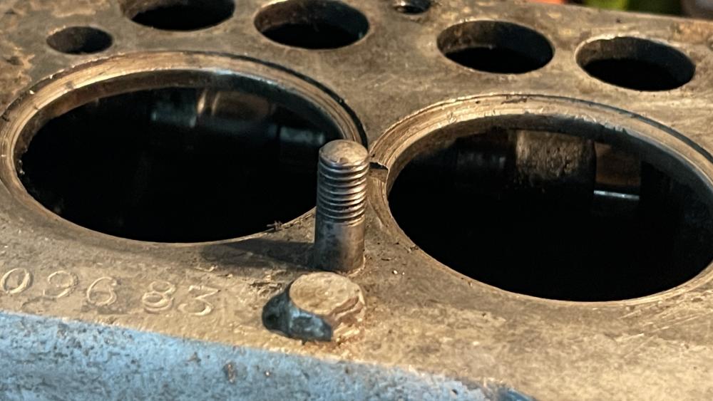

I am continuing to clean out the water ways in the cylinder block. I suppose if nothing else, I am “adding lightness!”
