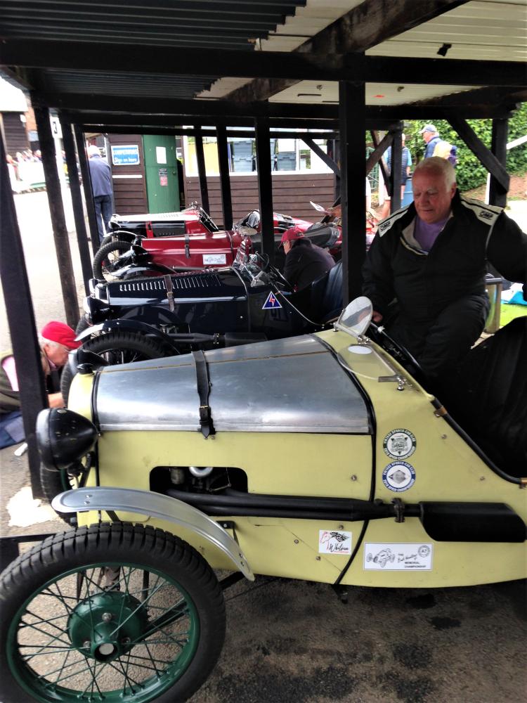

What I did today was go to Shelsley, a delightful day, not raining but not too hot, so good times for competitors. The usual big turn out of Sevens, but scattered about around the paddock. This was the best I could manage of a photo of Sevens.
I recognise that driver, I didn't know he was allowed out of Yorkshire!
Fear not, Duncan. He did escape briefly but is now back home in Yorkshire where he belongs.
Good to hear! Need a bit of solidarity among the Tykes. Nowt wrong wi' a raiding party now and then though.
