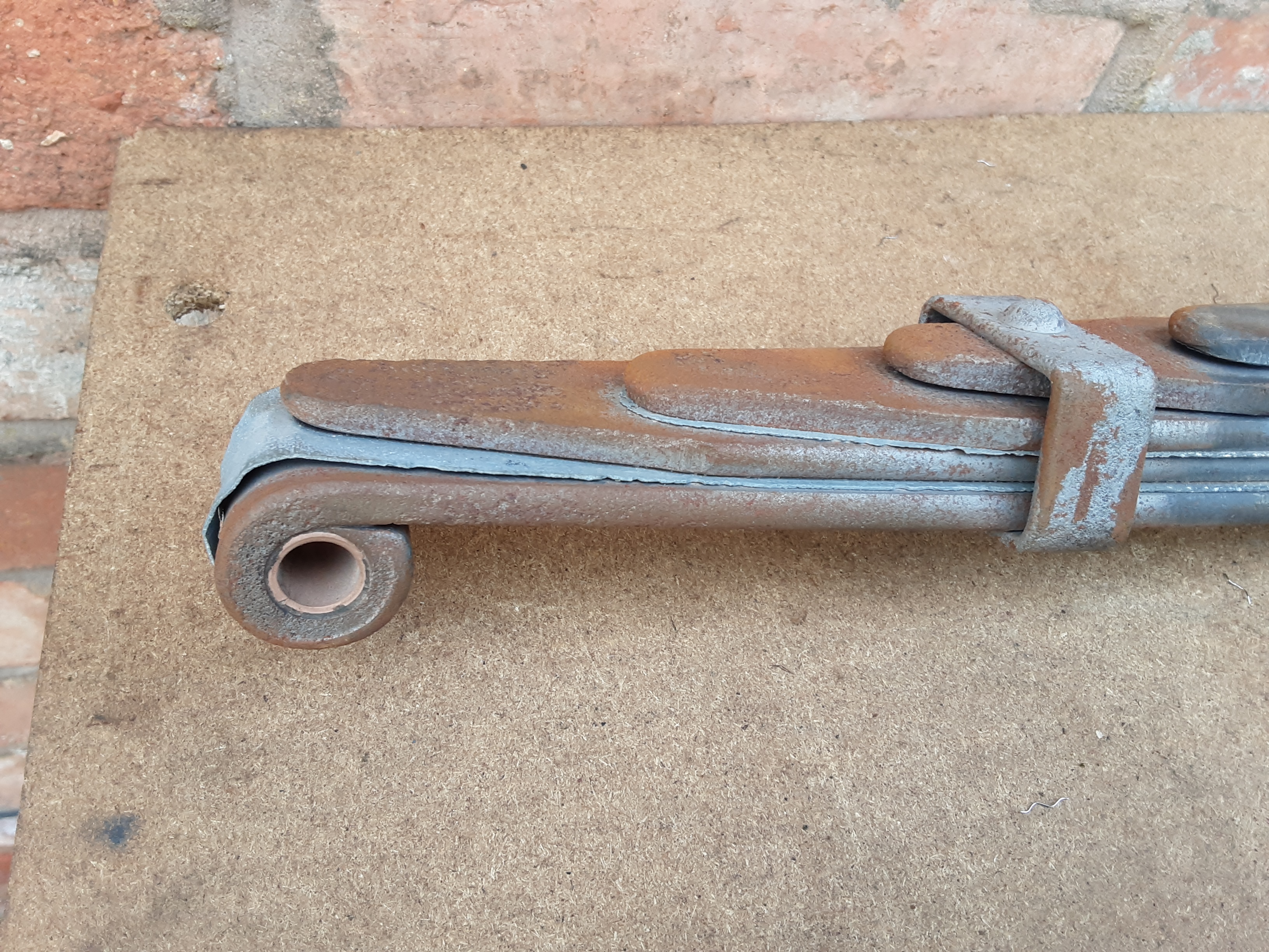

(26-06-2023, 03:39 PM)AustinWood Wrote: Friction between the leaves as they flex has a damping effect. I have always assumed that binding springs with cord was done to increase the damping effect.
Daimler springs were a beautiful pieces of engineering. There is a spacer between each leaf at the fixing point to keep the leaves apart. At the end of each leaf thear is a phosphor bronze 'top hat' section spacer. The 'brim' of the hat is the same thicknes as the spacer at the fixing point. The crown of the hat goes through a hole in the leaf above. It means there is no steel to steel contact between the leaves and each leaf acts independently. Thats what you got for paying £1,500 for a chassis with no bodywork in 1934. That would have bought you several houses!
 I noticed the other day that Tony Betts has an Original Ulster front spring forsale with zinc strips between the leafs to prevent wear - i would have thought tho that zinc would have rubbed through fairly quick ?
Link to image i cannt seem to post it:
http://www.7ca.co.uk/134235.jpg

The front spring on our Ulster has the zinc inter-leafing. I believe these to be original ( 1931 ) and there appears to be no / little wear.

As do the rears on the sets of original springs we have.

Zinc interleaves were used on front and rear sports springs (normally stamped 9C, from memory) to reduce corrosion, friction and noise.
A set came with the AB Chummy and are now fitted to one of Steve H’s cars.

Zinc certainly has a "lubricating" quality (strips laid on a concrete floor make sliding heavy machinery surprisingly easy) but it also is very reactive and I would expect a degree of electrolytic action in contact with steel. This would be likely to damage the zinc rather than the steel...
#30
The leaves are sacrificial and can be replaced, the more expensive, and harder to make, steel lasts longer and remains functional.
Having said that, many of the interleaves I have seen appear to be original and still intact.
