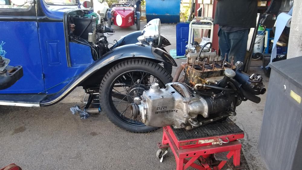

Went on to Oxfordshire Sevens where Hilda was treated to a gearbox transplant, fitting a close-ratio (22/29) gearbox from Andy Bird. Also changed the high-compression cylinder head for one which doesn't have worn (and leaky) core plug holes, and fitted a refurbished fuel gauge sender with new cork gasket, resulting in a working petrol gauge for the first time in 5 years  Smile
The drive flange in your gearbox is very unusual, David?
It looks like a clutch release bearing tied to the flange R
It does, I agree, Ian.
Yes it was! I was careful to remove it before fitting...
I was very pleased to find that the new gearbox is a great improvement: I now have to start off in 1st gear instead of usually using 2nd, and I can get up to about 45mph in 3rd if I want to. It's also quieter in the intermediate gears and we've stopped the rattle which was being transmitted up the gearlever.
(11-04-2023, 09:51 AM)David Cochrane Wrote: Yes it was! I was careful to remove it before fitting...
That's good to hear David. I've built up a box with the same ratios for my Nippy but the rest of the car has a way to go yet so I haven't had a chance to try it.
