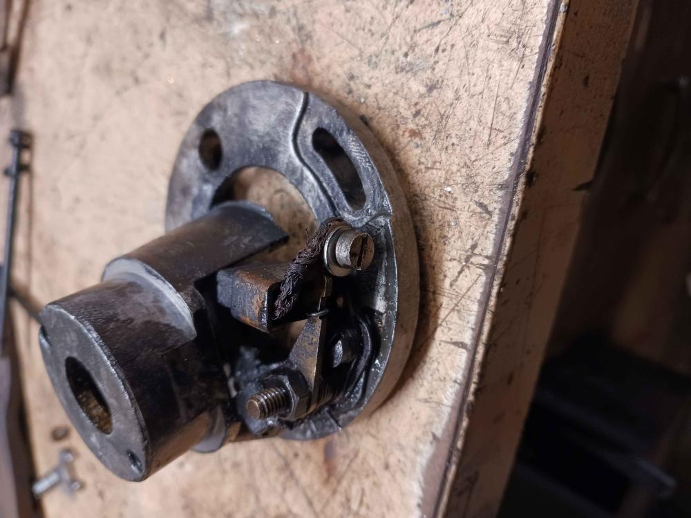

Quick check over when filling up with fuel reveals that the end cap of the dynamo is wobbly. Pulled the cap off - end casting has broken! Aaargh!
Drove home slowly with dynamo switched off and pulled it apart in the workshop, appears to have been cracked/broken forever.
Sadly, although I have a spare DFL, it doesn't work, most likely due to a a duff armature. I'll probably have to pull it apart to use the casting to repair the Chummy one.
