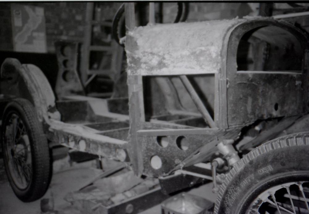

Here are some further photos of John Heath's workshop - the beginnings of the restoration of my fabric saloon.
The hydraulics were fitted incorrectly (all trailing shoes) by a subsequent owner. Now returned to original and a more effective cables.

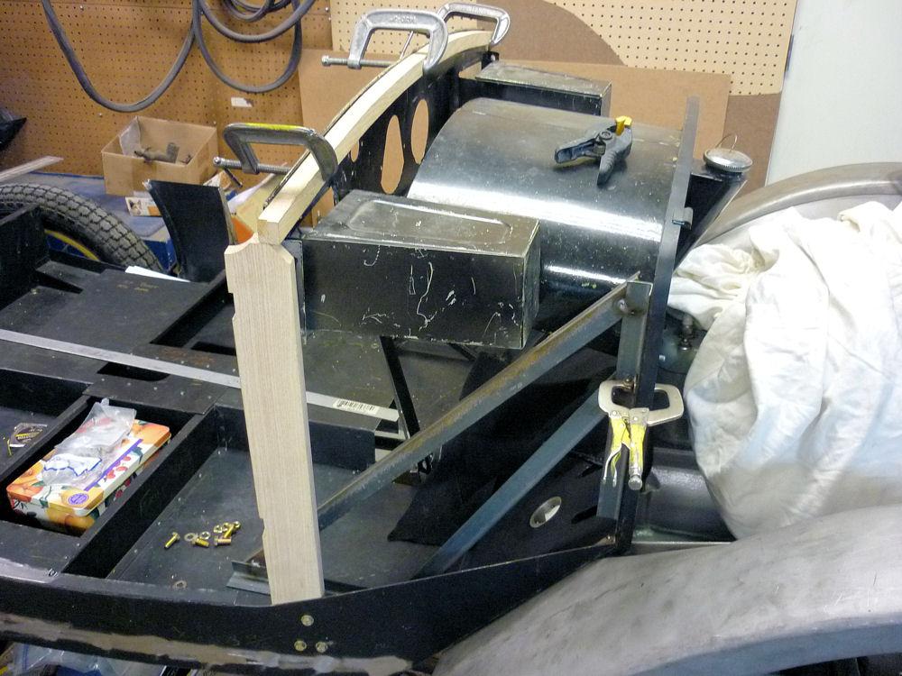

PROGRESS AND MORE QUESTIONS
The day was spent installing the A pillars which took some time to get right.
After this was done I did a trial fit of the dash board, screen bottom rail, and the fuel tank. Things don't exactly fit that well which was to be expected but there are a few questions regarding things.
The position of the dash where it sits against the screen bottom rail  looks suspect as far as the scuttle alignment is concerned. Should the wood rail sit under the folded lip as in the picture or should it sit lower with the wood exposed above it?
With the dash in the  position shown,  the fuel tank sits too high at the back with a gap between the bulkhead firewall and the front face of the tank.
Do any of our more experienced restorers have any suggestions or observations that can improve the fit?

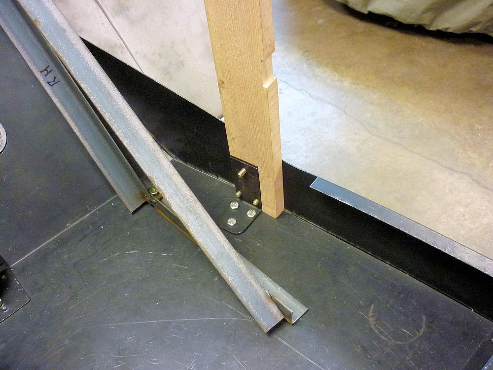

I also think that the bolts you have used to hold the bottom of the A post will cause you some issues. They are screwed from the inside - from memory.

I think I've solved the issue
John Heath instructions say:
What he didn't say was whether to install the wood screen rail on top of the A pillars or between them. It looks to me that if the screen rail is installed between the A pillars the dash will drop drown about an inch which looks like it would make it all line up.
I will put the steering column in and check the dash height against the column  bracket that bolts under the dash.

The lower bolts you are looking at are temporary as the brackets have been taped for countersunk bolts to go in from the outside and then lock nutted on the inside.

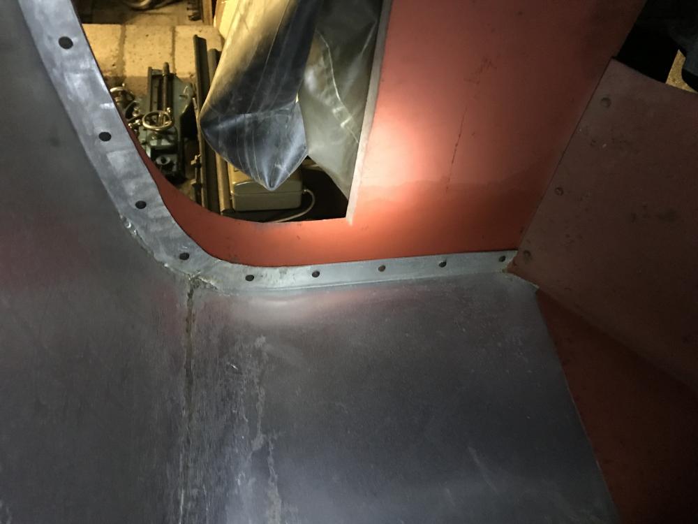

The scuttle is the aluminium skin that sits over the petrol
tank and down the sides to the flitch plates. Some discussion on it here: https://forum.wordreference.com/threads/...e.1724233/ and the closest term for North America seems to be cowl.

You are right to be cautious and all these vans are different, however one basic principle you can use to check your assembly is that a line from the top of the curved screen batten to the top of the radiator shell (not the neck, the shell itself) should be almost horizontal (slightly lower at the front by about 1/4") and just less than 90 degrees to the front of the bulkhead. If you rest a piece of bonnet moulding on top of the bulkhead lip then the line from the screen batten to the rad shell should just touch the top of it.
Assuming your pillars are cut to the right height I would expect the rail to fit between them. That how the saloons work and that appears to be what John did.
The aluminium panel in front of the screen (the scuttle top) has a right-angled upstand against which the screen fits. The top of the dash should line up with the top of this.
I would suggest that the cowl/scuttle dictates the final shape of the woodwork, not the other way around.
The dashboard sits proud of the scuttle/cowl lip, to hide any shape differences. The windscreen frame rubber does a similar job.
The A posts are help in place by the windscreen frame, screws in the door opening and screws from the bottom bracket.
The top wooden section, under the cowl is screwed into place from the top and through the body skin - these are hidden by the windscreen frame.
In the photos below, the top of the A post has slotted to accept the curved section.
