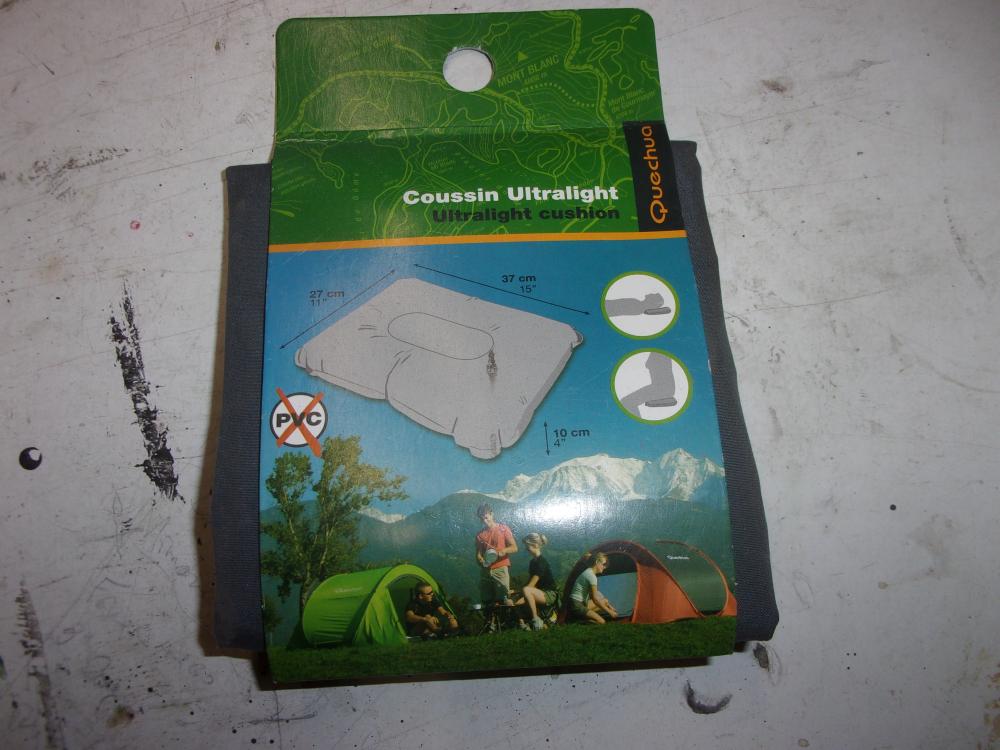

I found an intact original recently     I'm just wondering whether to fit it as I've fitted some inflatable cushions I found in Decathalon which work well     they require very little puff to make them comfortable too much and you tend to roll off.
