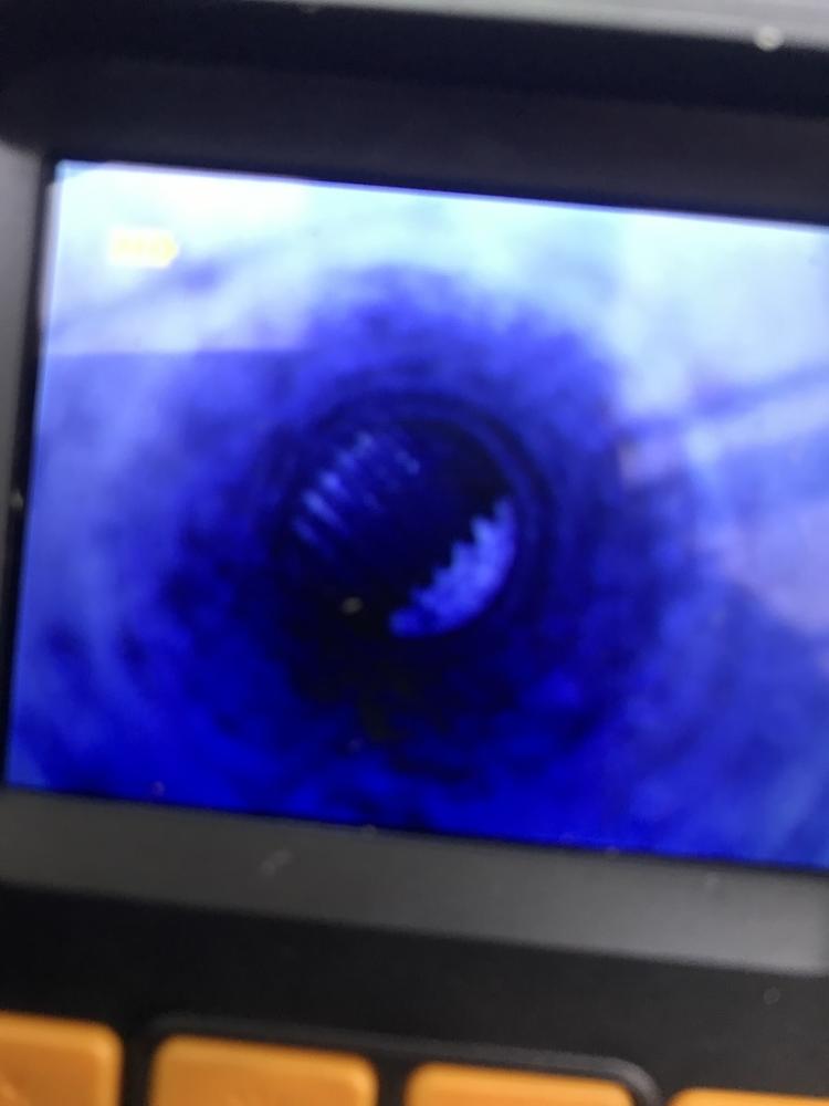

We inside the oilwats with a camera and they were still dirty so we put them in his hot clenaing machine again.

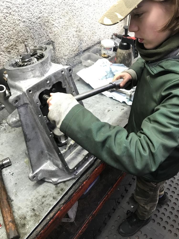

While that was working I blast cleaned the gears, the gloves are quite large!
After that we looked inside the crankcase again with the camera and it was much cleaner.

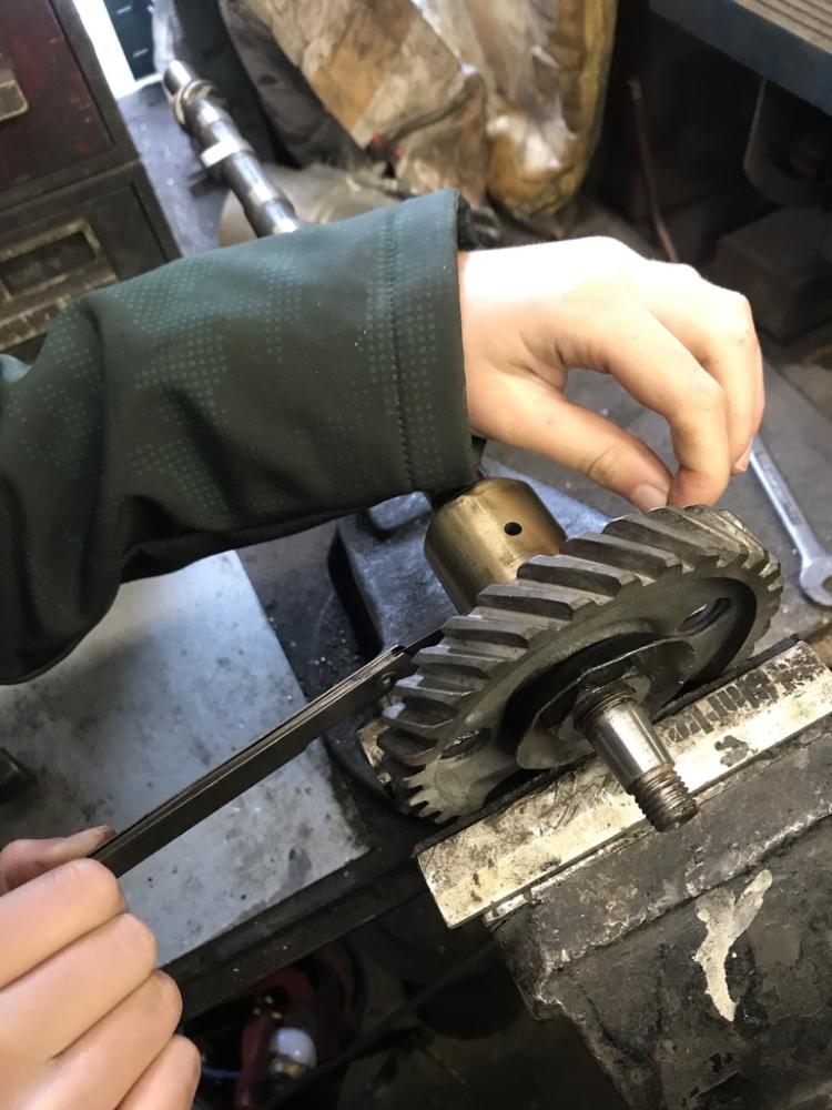

We checked the gears had the right amount of space between them using feeler gauges.
Then we fitted the big gear to the camshaft, dad had got this ground and it was really smooth.
We fitted the brass bush so it slid in and out easily and then tapped it to take a bolt, so it would not move about.

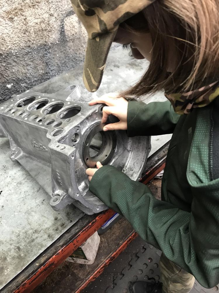

Then wwe needed to make sure the steel ring was a smoth fit in the back of the crankcase, this took quite a long time.

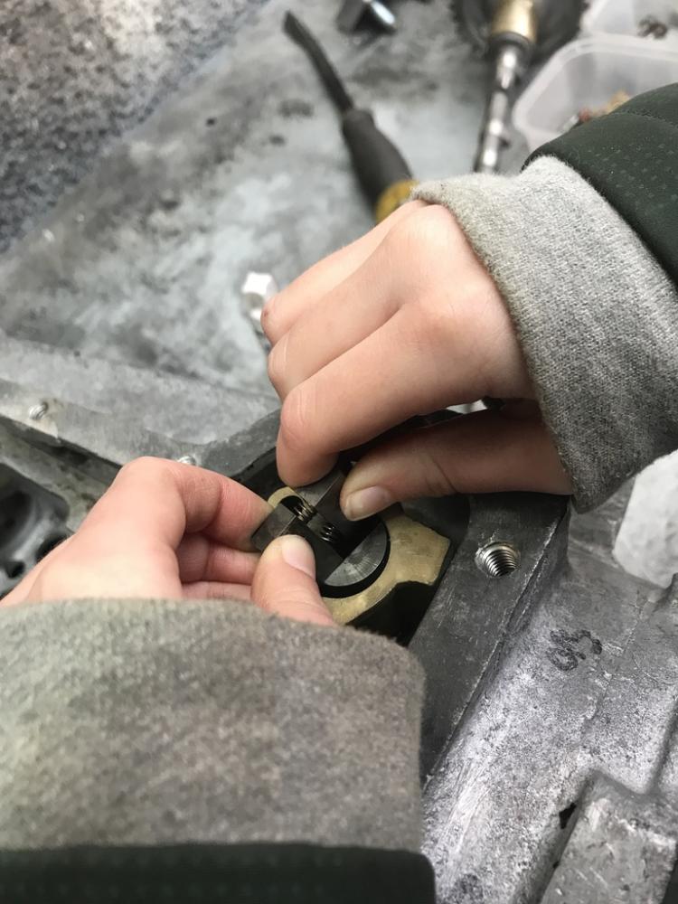

I put all the bolts back in the oil ways and the spring and ball back in.  Thien I built up the oil pump and made sure the blocks were in the right way round.

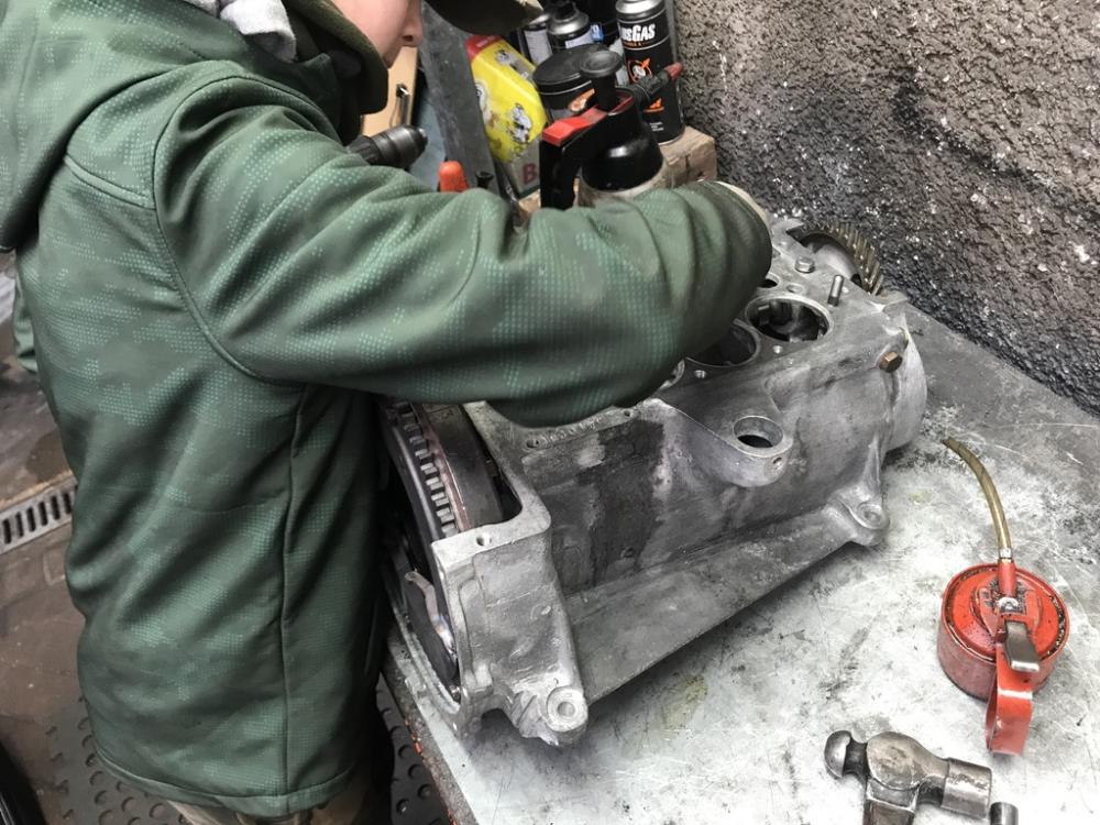

Putting the crankshaft in was a bit of a puzzle!  I helped to pull the bearings on but it was quite hard so dad did most of that.
I put the bearing on th eback and then slid the steel ring in, it all lined up really nicely.
The camshaft was realy tricky but dad helped me get it all lined up and grease kept the rollers in the right place.

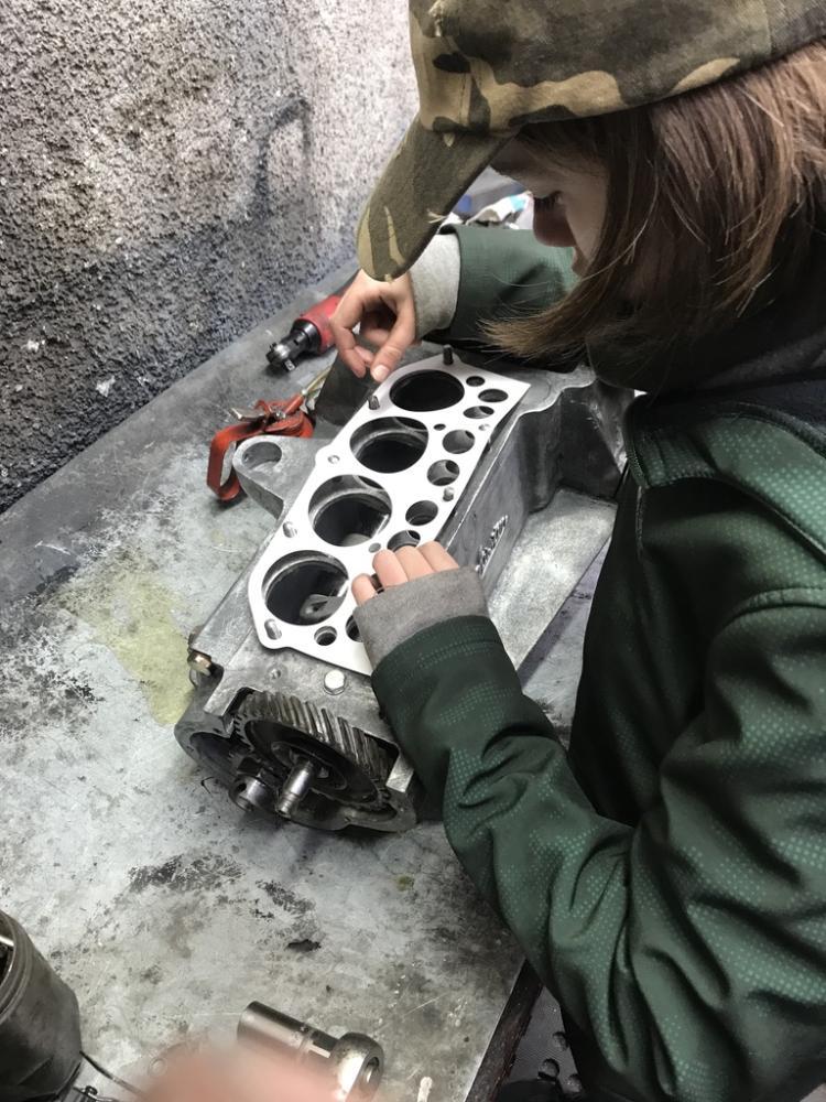

We made sure everything was really clean and put the white gasket on

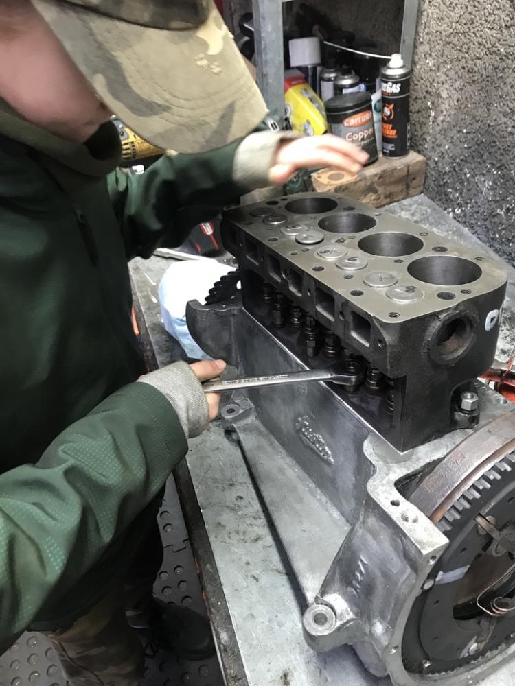

Then we put the block on and tightened down the nuts.  Dad was not happ with one of these so we took it all apart and put in a new thread.
At last it was on and I could do the "tap, tap, tap" I was so excited.
https://youtube.com/shorts/PNBVOALpej8?feature=share
I had to make the tool click and then we knew it was tight enough.
