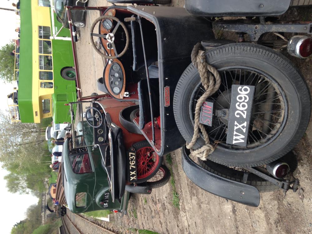

It is the Severn Valley Spring Gala, so a small Saturday gathering of cars at Eardington. There was an open topped bus in service between Eardington and Bridgnorth, one of a fleet owned and operated by a couple of lads who also collect fire engines, and the girlfriend of one of whom ahs an Austin Ten. And we think that some of us have collections! Sorry, no photos of a passing streak in black livery, Sir Nigel Gresley, and certainly no snaps of Purple Brenda.
[attachment=
17726]
OK, which expert is going to do a lesson in how to get the forum to take the image in the format on one's own computer. Merely shouting "portrait, damn you, portrait" at it on a Sunday morning merely wakes the missus and gets the dogs howling.
I’ve lost the will to live trying to get photographs in the correct orientation these days I just tap th3m and they re open in a new tab the correct way up...great pic by the way!
