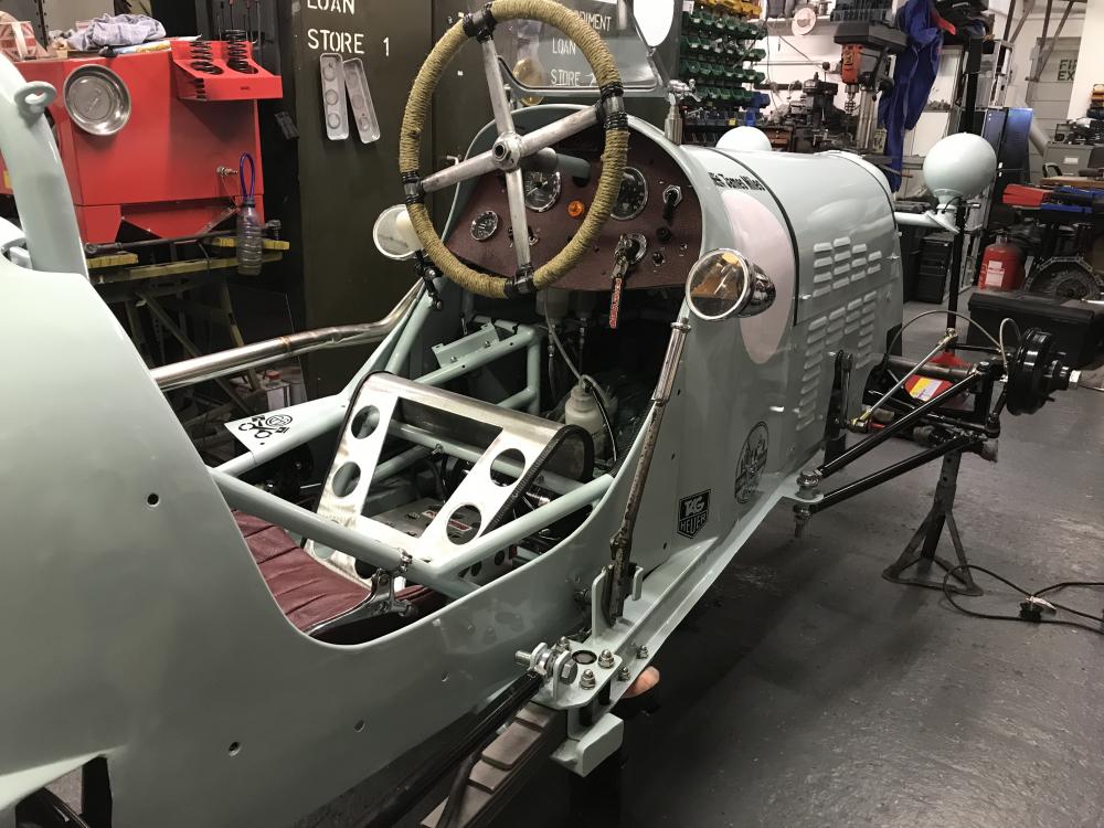

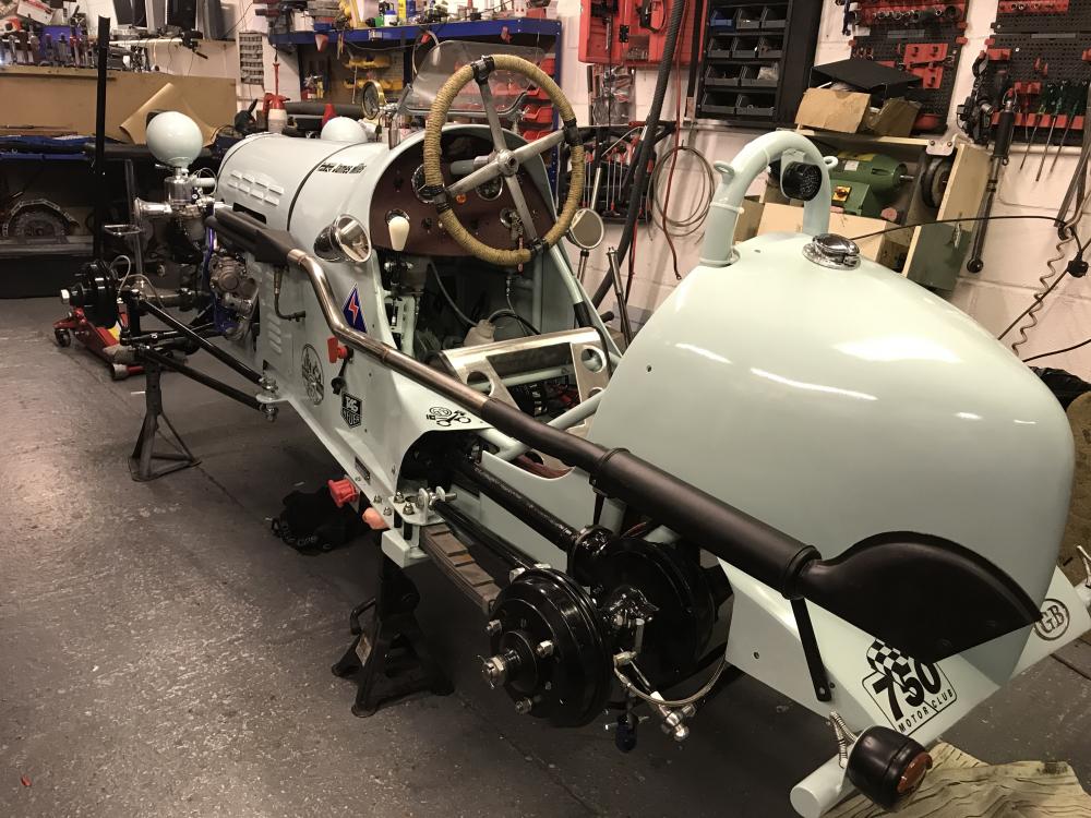

Here are some pictures of my 1936 Single Seater project. It has taken 21 Months to build and is just about ready now.
She is racing in Angouleme on the 17th September and then hopefully I shall do the Historic 750MC Formula next year.
Always glad for peoples opinions.

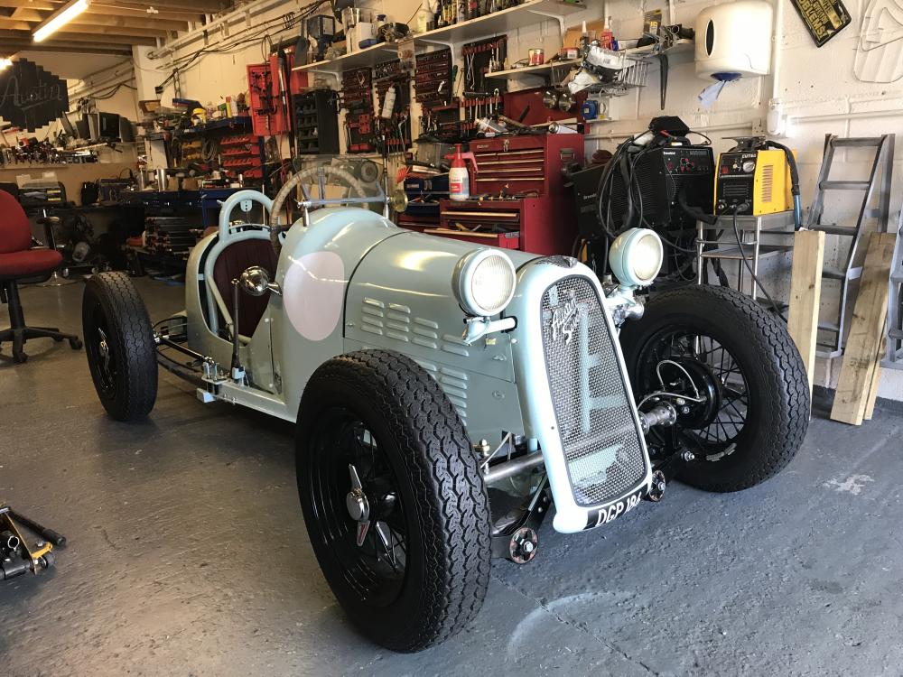

Very nice , mind that exhaust. What sort of speed would you expect to get out of her. There you are one of the classic questions . What's it worth and how old is it. My grandad didn't learn to drive in one. The

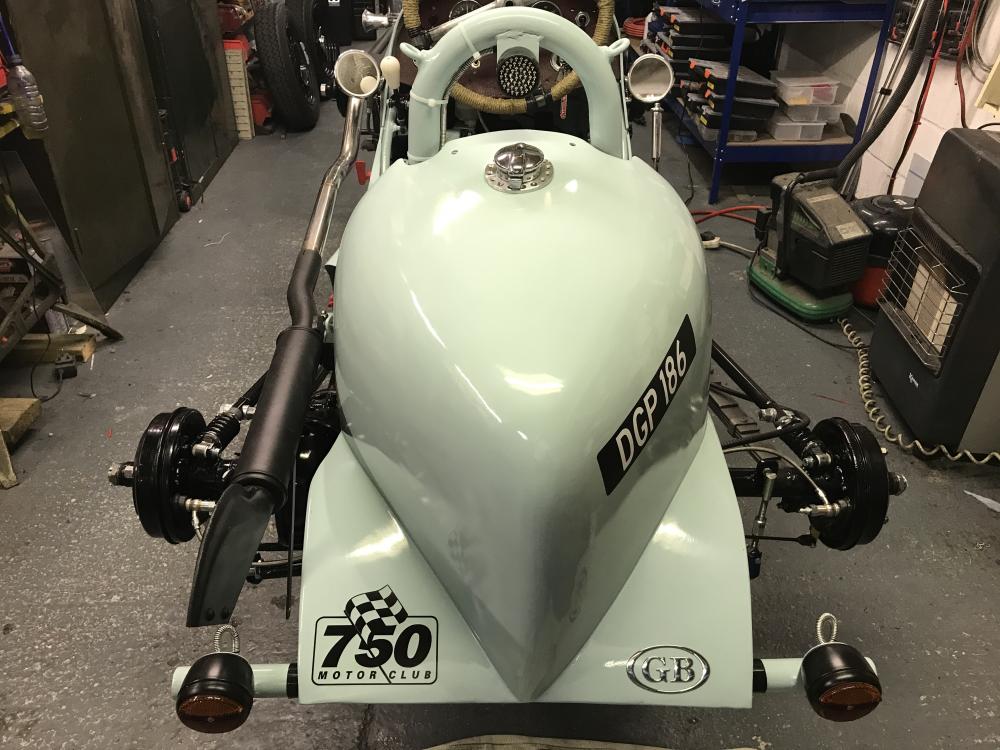

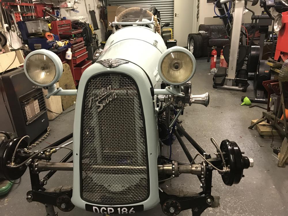

What's the story with the two piece front beam ?... those headers exit the hood side very nicely and with some purpose.
Have you driven on the road yet... how was it ?
Hi Albert,
So many hours I cannot tell you. Lots of obstacles to overcome but it seems very worthwhile.
The front axle is a 1950 design with an integral bearing / bushing assembly in it allowing the beam to twist a small amount.

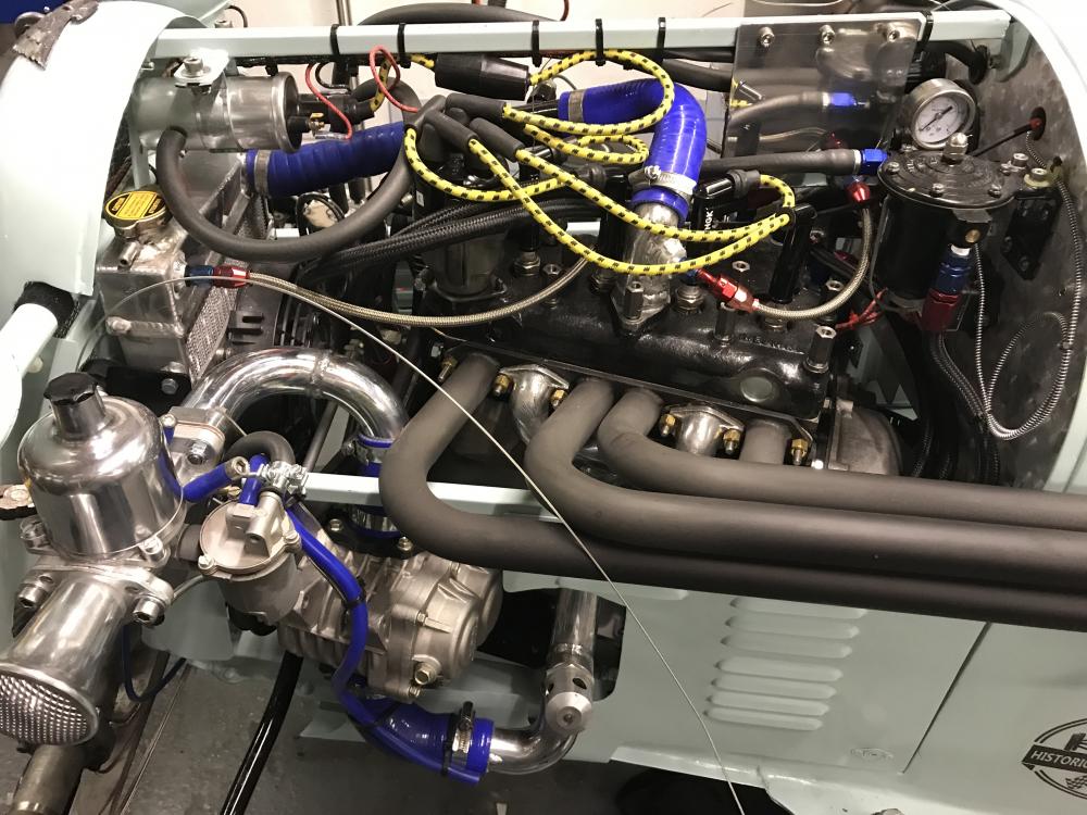

The headers are my design and creation but the back box is off a Harley, the exhaust note is perfect.
Yes driven it, now adjusting a few parts, pedal box and prop shaft length and UJ's. The suspension worked perfectly.
I am also going to fit a 4.3 ratio rear crown wheel and pinion to give the gears some more length. This will not be available till early October though.

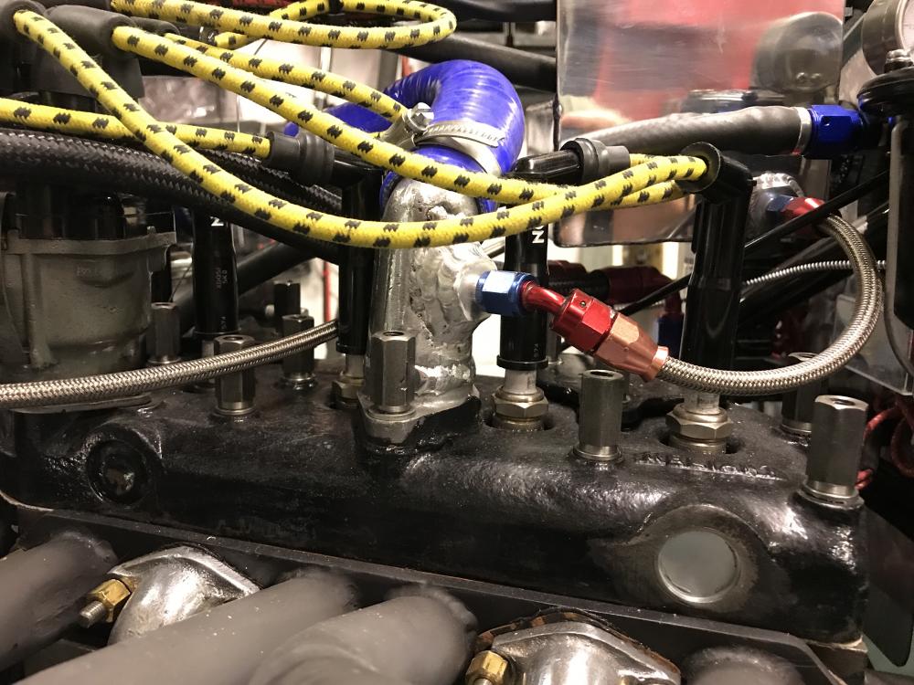

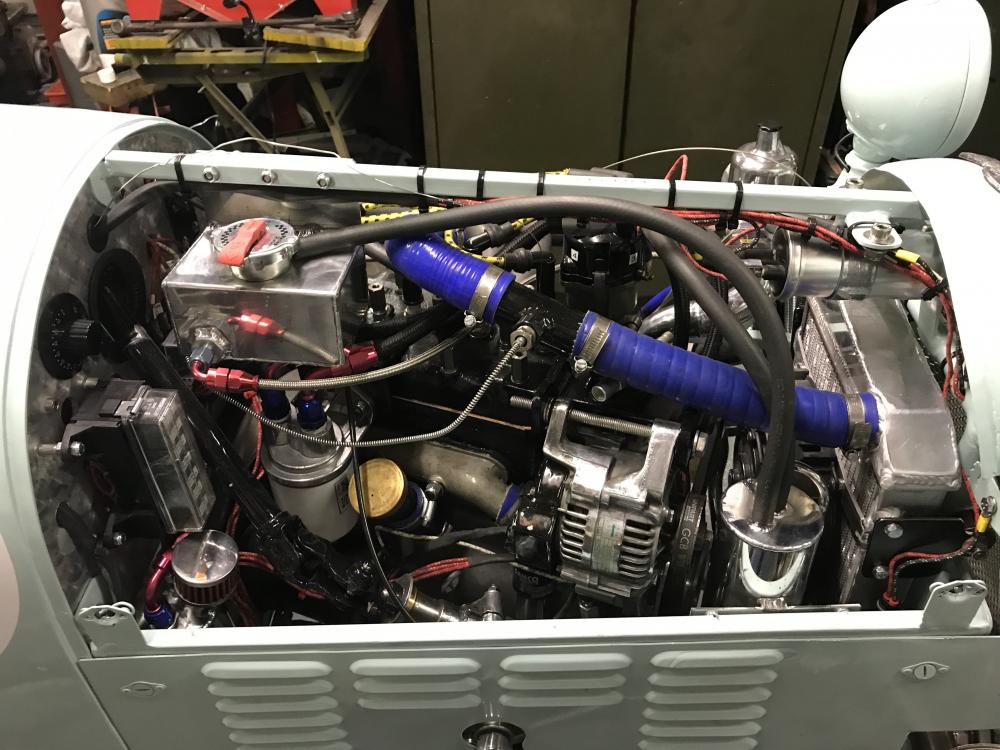

A few engine shots.

Its a mixture of mostly old as you can see and some new bits and pieces, not everyone's cup of tea but its running gear and chassis date back to the 1930s and I have tried to use all old bits when I can.
Development will continue for many years no doubt!

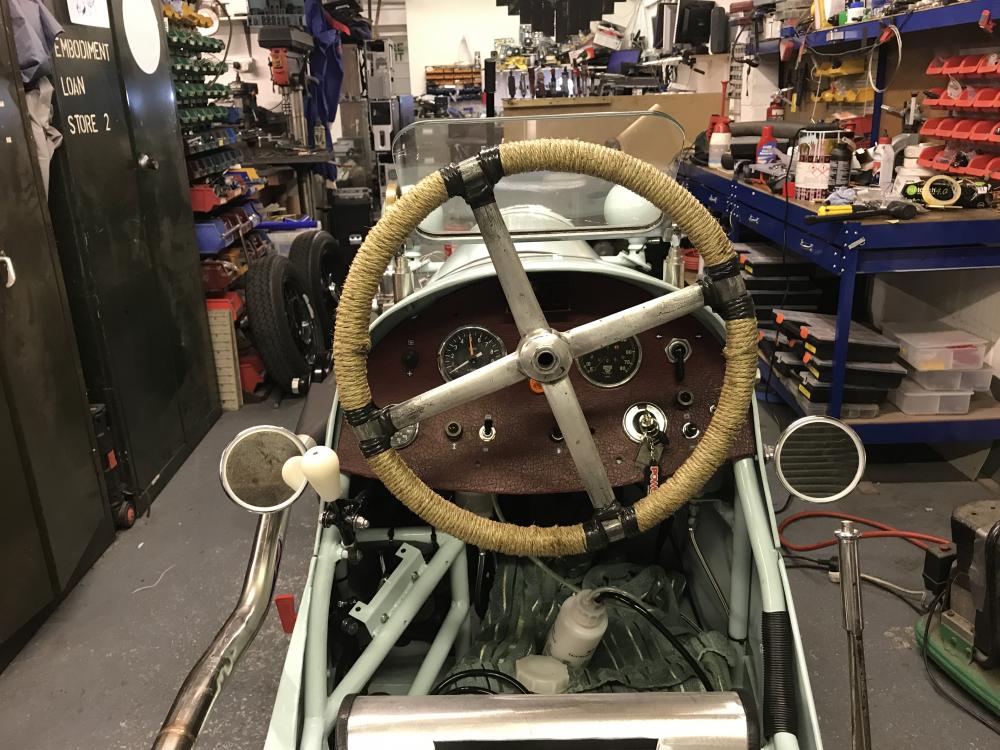

               One Question How does the spring on the control rod the runs above the rear springs at the diff end Work.
               I fully understand if you would rather not explain.
