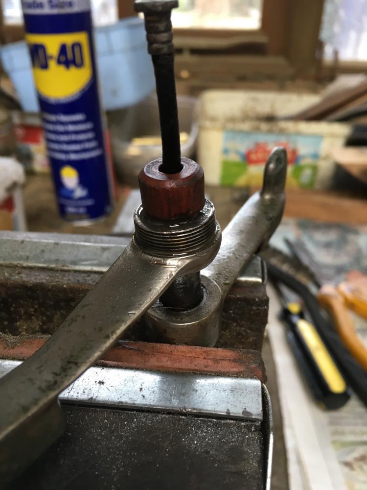

Does any one sell the insulation at the top and bottom of the tube or do people just make there own, I presume the ones in the photo below are original?  The top one came out but the bottom one broke up.
I had someone I know turn up a piece of nylon to replace my broken top insulator.
(01-03-2018, 01:52 PM)Douglas Alderson Wrote: Does any one sell the insulation at the top and bottom of the tube or do people just make there own, I presume the ones in the photo below are original?  The top one came out but the bottom one broke up.
You can make these out of hardwood/ nylon/ ebonite or similar.
Douglas, I'd be happy to turn them up for you from a Nylon 6 type material.
