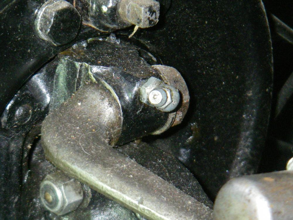

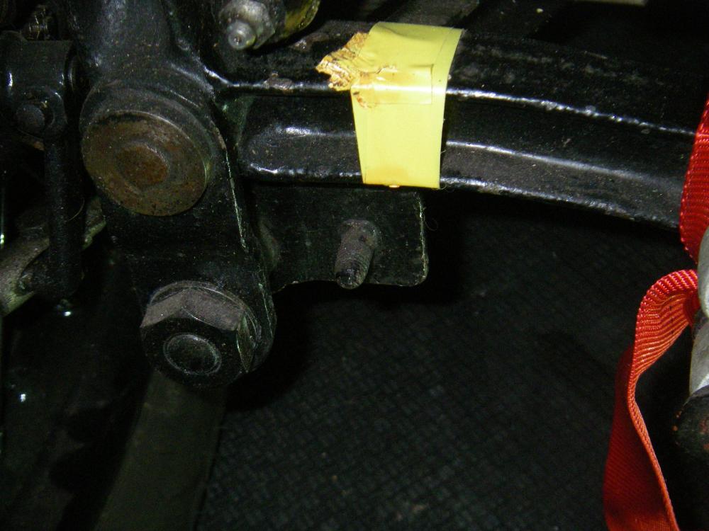

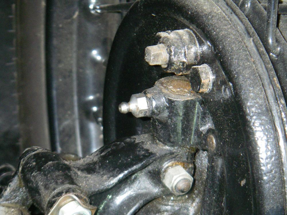

Ian, here are a couple of photos of what I have. As well, under the steering arm, there is a plate on the shock end that extends inward. It has a stud front and rear with threads, but nothing is attached. There is no duplicate on the nearside. What is this?

Erich, you confused us by saying they were on the steering arm, they are actually the 5/16 bsf grease nipple in the stub axle for lubricating upper king pin bush. Available from our cherished suppliers if you can not find then locally to you.

Thank you, Ian. Sorry for the confusion. I am just learning the Seven and spent most of my time working on motorcycles so my terminology is lacking. Any idea what the plate on the shock end is for in the last photo?

It is an owner modification Erich, it is hard to see from your picture so I am not sure exactly what it is there for, perhaps to secure the links made to lower the radius arms???
