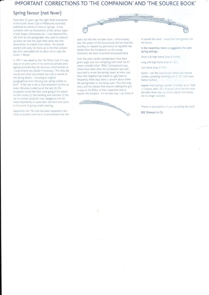

a note from my annotated page 80... not sure form what sources tho
1923..... 5 leaves SWB max 6", LWB highframe max 6.5" low frame max 3.5" sports max 2.5"

(15-10-2021, 08:55 PM)JonE Wrote: a note from my annotated page 80... not sure form what sources tho Possibly either from Bill Sheehans "Important Correction" in 1974 or "Important Correction" in 2010. I have a copy of both filed in my Austin Seven Companion page 80

Bill got those measurements many many years ago from the notebook of an old time spring maker in Melbourne, I believe

Did you know Ford made an Austin 7 part in their 4 wheel drive Sierra? Front drive shaft flange is same as A7 pinion shaft flange, if I remember someone pointing out? I have seen the formula for flat spring rates (the amount they flex for given dimensions and spring steel types) but when getting a front spring for a big 7 front axle on my Nippy gave up trying to work it all out, even using the dimensions of the new spring I had made (standard?) big 7 spring from what seems to be the only spring commercial manufacturer left. I have given in and am relying on the "well it all seemed to be ok with the old spring size". The BMC A+ engine is heavier than the A7 engine but then the big 7 spring is stronger than the 7 spring I have had no such problems with the coil springs for my Austin's distant relative the Reliant Scimitar. Here is what Bill sent out...don't know date. Dennis

So to bottom this out, there has been considerable assistance given on Facebook, in addition to what's on here
From info here, it looks like the 6inch of camber (measured to pin centreline) on my springs is the maximum quoted by Bill, slightly less than the maximum my father noted in his companion. From Facebook, Anne Williamson I have this info. From a Remax Catalogue So whilst I accept fully that is doesn't quote leaf thickness, it seems 6 leaf rear is entirely appropriate for a 1928 chummy. Looks like its worth the effort of trying them. Many thanks all who commented. |
