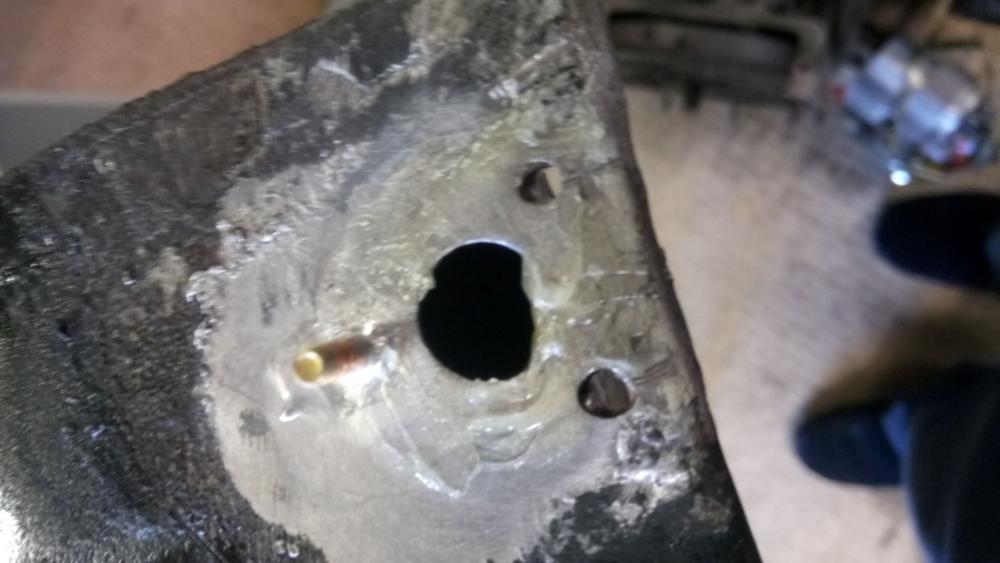

A couple of jobs needed doing, one was repairing the petrol tank. I'd gone round this with a fine tooth comb 18 months ago and attended to all the cracks and split solder I could see (the tank had been lozenged in the accident and was leaking badly). It was OK with water in it but when petrol went in, there was a very small drip, about 1 drip of fuel every 24 hrs. I determined it was from the outlet, so it had to come off:
I wiggled a 4BA screw into the top hole and soldered it in place. Here it is all fluxed up:
Finally, drilled through the bottom holes and put 4BA screws onto those as well. Then sweated the whole lot together, after tightening the nuts:
The tank now holds petrol, no leaks. Result!

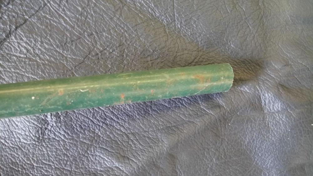

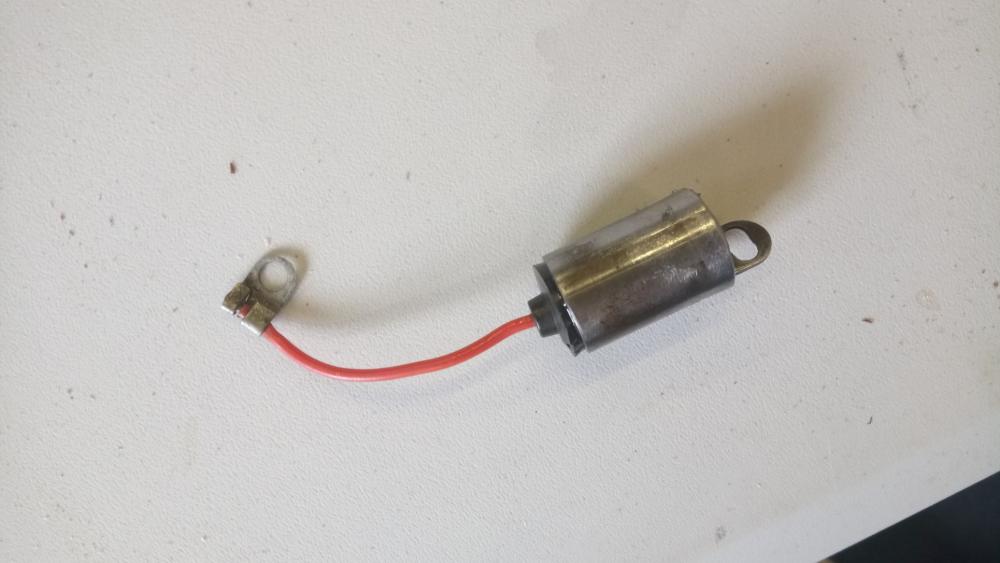

The other job, necessary to get the car running again was a replacement condenser. I've already had a rant about the poor quality SR4 replacement items so I decided to make one up. I obtained the capacitor recommended by the "Magneto Guys" and looked around for a bit of steel tube to hold it. Found a bit of an old swing seat in the scrap pile:

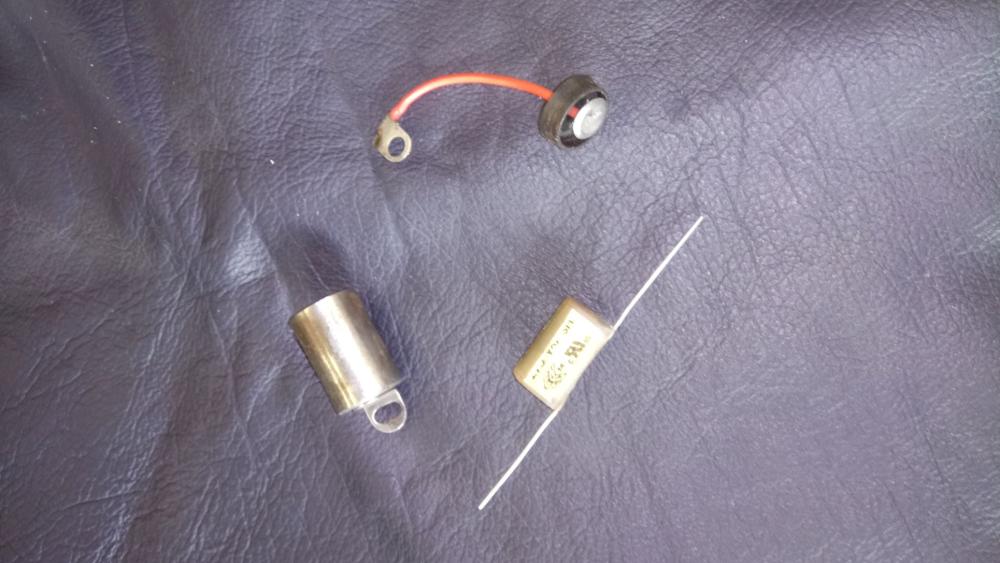

I added the cap from the poorly made, modern replacement and soldered it on to my tube. I reduced the size of the capacitor by filing the corners until it fitted the tube and selected the lead from the modern replacement to be my input lead:
I sleeved the capacitor in heatshrink and soldered the input lead on:
The capacitor was inserted into its new case and "potted" in with Araldite.
Voila, a new "Condenser"!

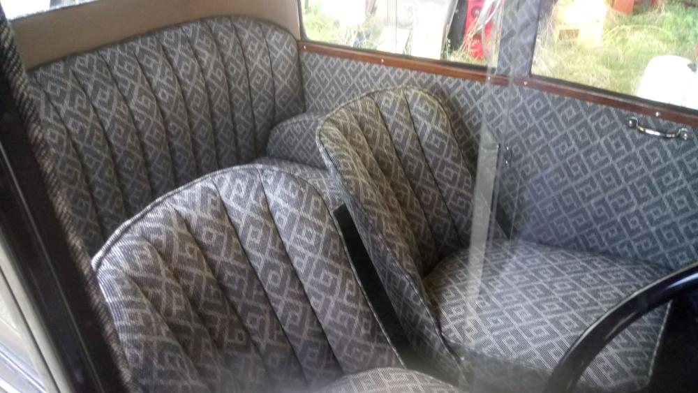

Finally finished the trim! My friend, Aileen came round last weekend and completed the wheel arch covers for me, I find sewing a reliable, straight seam a trying experience.
Dismantled the car and fitted the covers today, looks good!
My trick to avoid Hidem Banding, which was not invented until the 1930's, is to use a "curtain" of seat material, folded in half and ironed to give it a sharp edge. It's then pinned into place with braid. It would be have been nice to use pasting lace but I didn't have the capacity for a second mortgage! I think the results look OK; the braid was cheap enough at a few quid from the sewing shop.
