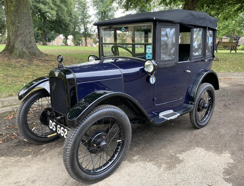

Some weeks ago some of you may recall I finally, after 50 years of Seven ownership, bought my first Chummy, a bright yellow version described as the itch I needed to scratch. Well the inevitable happened and, like buses, you wait an age and then 2 come along together. 3 days after I got home with the yellow car, I got wind of a car being sold locally on behalf of a chap who no longer was able to drive. I resisted the temptation for a number of days until I finally decided, it would be rude not to. You can probably guess the rest. The Yellow car is now with a new owner in Hampshire (another long term A7 man, I am pleased to say) and this now resides in the garage in its place. It has had very little use over the recent years and has had to have a rear brake rebuild (and a huge amount of excess oil removed from the diff, the root cause of the problems) and the Updraft carb has been ministered unto by Steve Hodgson. After a little light fettling, it seems to be running reasonably enough now for me to venture out for 10 miles this morning. Even that trip saw a huge improvement in its running so I will leave everything else alone until it settles down after a bit more use and starts to 'loosen up'...

Looks even better out on the road Hugh!

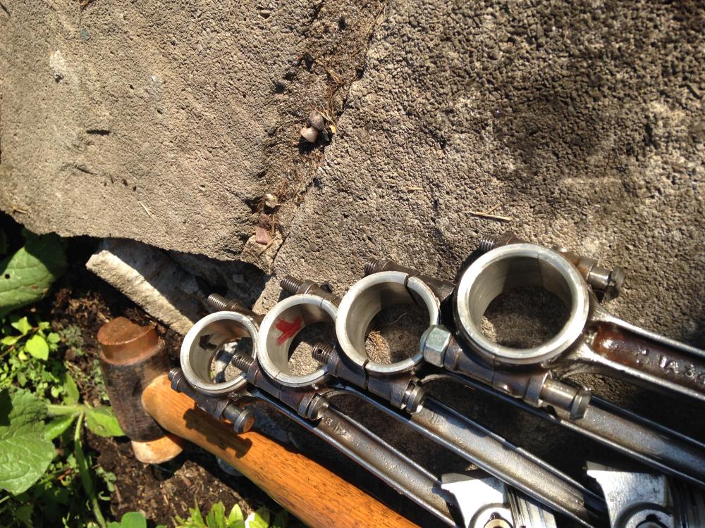

Having split block from crankcase to install a silicon gasket, valve seats were re-ground and tappets adjusted. For a good fifty miles the Ruby was nearly silent and almost totally oil tight, splendid. Then suddenly a dreadful knocking starts, fortunately barely a hundred yards from the house, so straight back home, and immediately suspecting a run big end, drop sump and split big end bearings. As the picture shows, no evidence whatsoever of big end problems, so further diagnosis required. A couple of phone conversations suggested the next possible noise source might be to do with the camshaft. Before removing manifolds to reveal the valve chest cover, I idly poked a screwdriver between the block and the dynamo bracket. I then picked up a square headed object from the floor, and said several very rude words. The forum over the years has had numerous suggestions as to the replacement of the original, with alan headed set bolts etc, but all seem to require engine out in order to drill and tap the crank case. Any thoughts? I am beginning to fear that those damn Morris's might actually win a prize on Ian Grace's Rally this year, Seven numbers are reducing daily.

Very Nice Hugh
What year is it?
Joined: Aug 2017 Posts: 1,223 Threads: 72
8
'27 and what I really like about it is that it is an original body, admittedly restored and repaired where necessary. The doors shut with a very pleasing 'clunk' It was restored by a chap I know here in Cambridge probably 40 years ago and looks very little different from the day he finished it. It's a credit to him (though he isn't the chap I in effect bought it from) I feel very fortunate to be the current custodian....

Steve, Where had the square headed stud come from. I can only recall one square head stud on the engine and that holds the camshaft bush what’s more the block prevents it from unscrewing itself.
