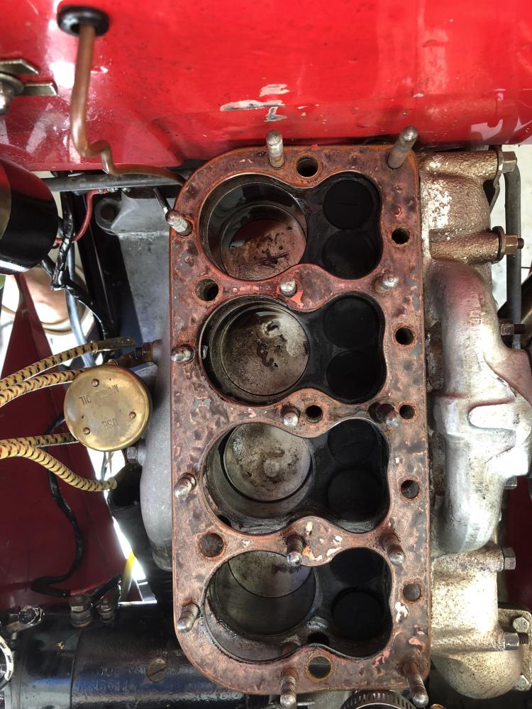

I'm wondering if anyone can give me some pointers with an issue I'm having.  I've recently rebuilt an A7 engine  (2 bearing, oil jets, 30’ oversize) and it's letting too much oil past the rings.  So much that it’s blowing a lot of blue smoke, fouling even the hottest of plugs, leaking out past sparkplug #2 and when I inspected the pots you can see the oil ponding on the top of the piston (see fig 1).  Having the nickname of “old smokey” is not something I aspire to!

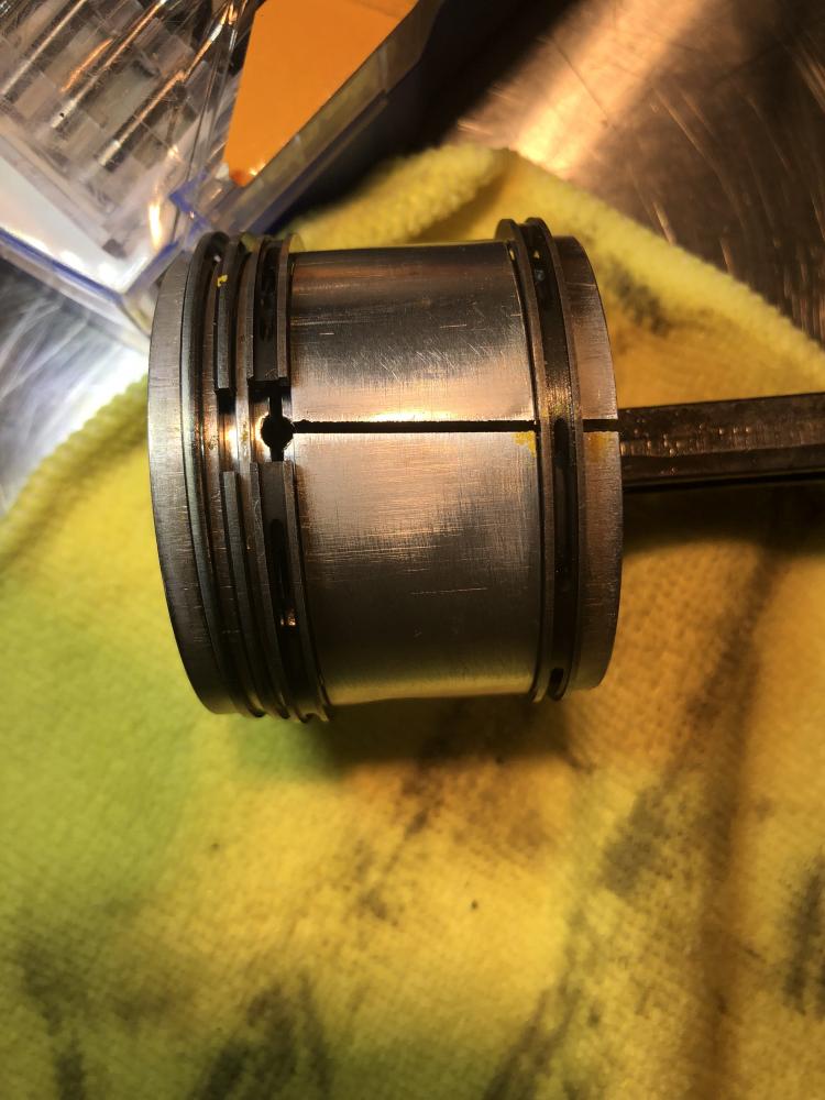

I used the split skirt pistons that had been in there before the rebuild as they seemed fine, nice fit and no nasty marks.  The bore was honed and I installed a new set of rings, one oil at the skirt's base and another oil ring and two compression rings up top (see fig 2).  Before the rebuild there was no excessive smoke, the rebuild was due to a bottom end bearing failure.
My theory is that oil is bypassing the bottom oil ring via the split in the skirt and to an extent the same for the upper oil ring as the blunting hole at the top of the split extends nearly to the top rail of the upper most oil ring (fig 3).  The worst case scenario would be if the blunting hole aligned with the ring gap.  In this case there is nothing to stop oil migrating from the inside of the piston to the 2nd compression ring.

First of all, I'm no expert, but I reckon my eyesight is OK...
Looking at your photo of the piston and rings I can see that the top compression ring appears to have a tapered profile as there is no apparent contact wear on the lower portion of the ring face. The next ring down appears to have a shamfer on both upper and lower edges. Could these two rings be mis placed?
Furthermore, the two oil control rings have two contact faces, one of which is slightly wider than the other, although each ring is fitted upside down relative to its sibling. The fact that you've got the gap on the upper oil control ring coincident with the hole in the piston skirt would suggest that it's not helping much with oil control.
Just my observations, I might be talking bollocks. (it's usually the case!)
