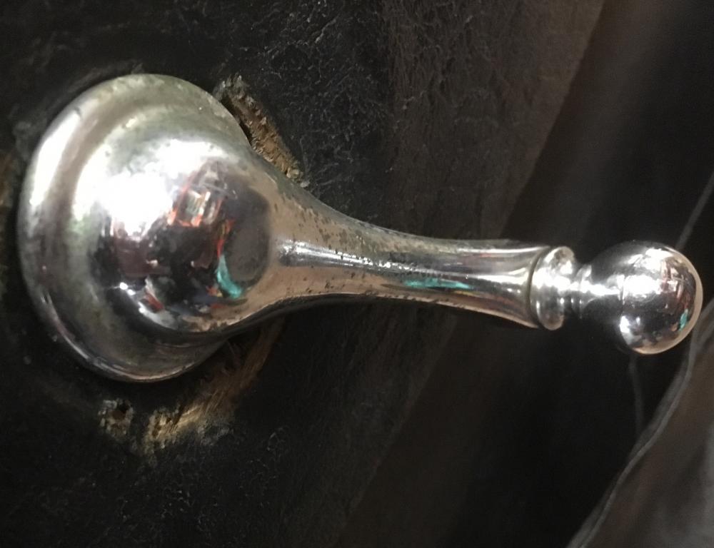

Sorry to ask the answer to what I feel sure is a simple question. How do you remove the winder handle? Do you carefully prise it off, and therefore is there a spring clip either on the handle or the spindle. Thank you.

Can you photograph the type of handle you have please.
(06-02-2018, 09:57 AM)Ruairidh Dunford Wrote: Can you photograph the type of handle you have please.
Certainly can.
Is that clear enoughRuairidh?
Hopefully better pic. of handle:
(06-02-2018, 09:49 AM)Austinsixandahalf Wrote: 1930 Mulliner Box saloon with suicide doors.
Having seen your recent pictures I have to say that I do not recognise the handle, but You may find a small catch on the back which needs moving along the axis of the handle by pushing with a suitable implement such as a screwdriver, to actuate a locating collar which holds the handle on the spindle.

Thanks Robert. I am familiar with 60’s classics, where there is a handle, with a separate spring collar, and a pin into the winder shank - but this is completely different. Will investigate further!
These look the same as the Austin bodied RK saloons.
There is a catch on the back of the handle. If I remember correctly it has to be slid away from the handle towards the knob on the end then it should just pull off.

These are Hobson Perfect window handles fitted to late 20's - early 30's saloons. To release, you need to pull against a catch located to their rear. See photos of the underside and my scrap box tool for releasing them.

I agree - Hobson Perfect are a standard fitment and they are removed as illustrated by Steve.

(06-02-2018, 11:46 AM)Steve Jones Wrote: These are Hobson Perfect window handles fitted to late 20's - early 30's saloons. To release, you need to pull against a catch located to their rear. See photos of the underside and my scrap box tool for releasing them.
Thank you both. Made a tool to fit, and they came off a treat! It’s what lurks behind that’s more worrying, the winder mechanism (driver side) will go down, but not up. Ran out of garage time, but thinking it could be the quadrant thats kna, sorry worn. Amazed to find they had pozidrive screws in 1930.....
