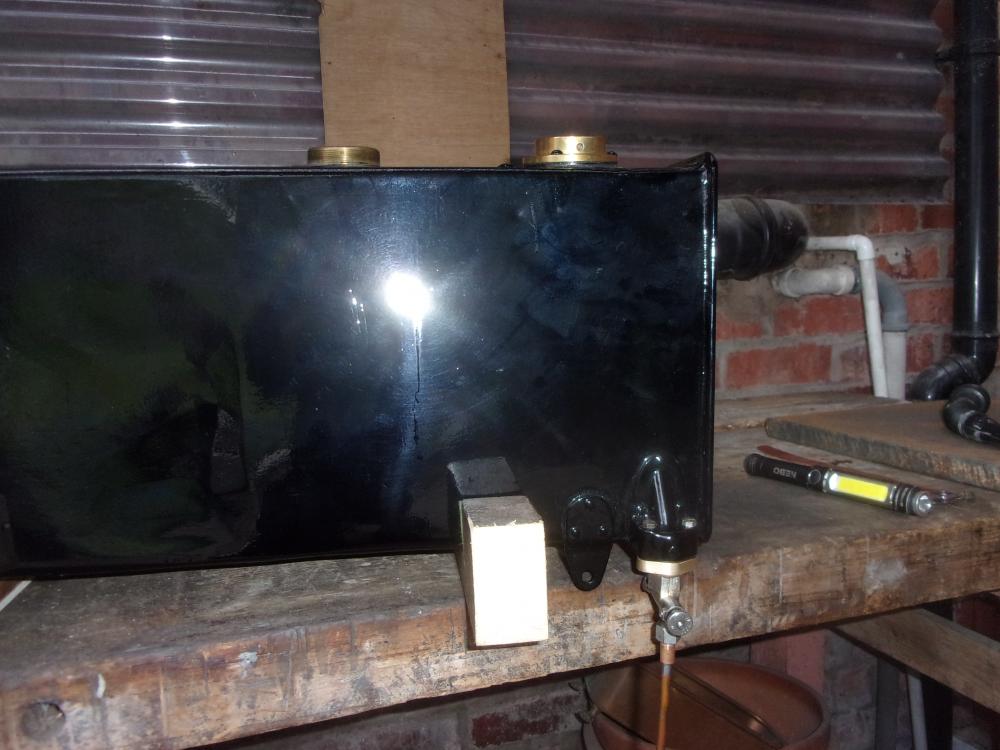

    Tested, no leaks and we have 1 gallon reserve. Yes the brass one had  3/8" BSP thread, so I tapped a piece of 5/16" plate 3/8" BSP screwed the tap in tight with a joint washer and then marked the plate out for cutting to shape with the main tap under the bonnet. The outlet to the carburetor is a Ewarts special smaller than 1/4" BSP and may heed opening up.
    I opened the outlet up to 1/4" which gives a much better flow. I suppose an hours work with a Dremel and it could pass for an original.

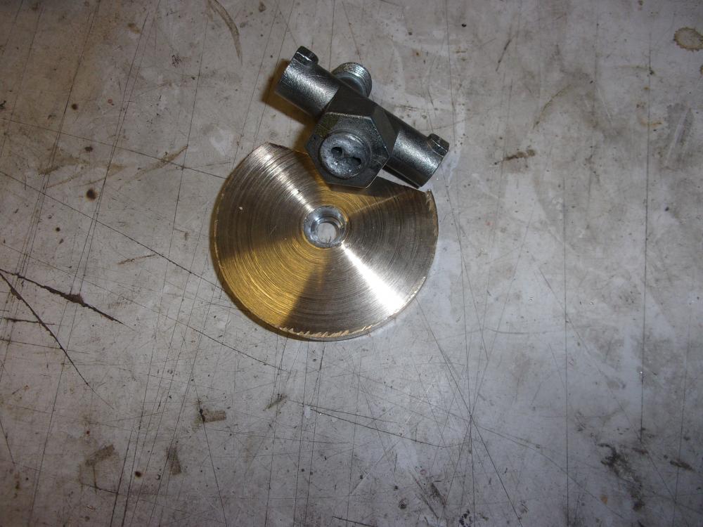

Well it's more like the flow from a standard tap now, before I could wee more. I've worked out how to do this conversion so it would look like an original by turning the 3/8" BSP down and silver soldering the tap to the flange.
