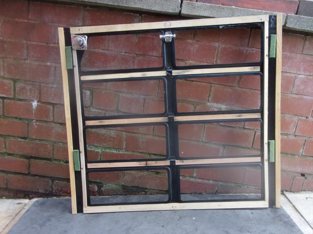

    Refurbished an RN sunshine roof today.

(05-05-2021, 08:35 PM)Dave Mann Wrote: Refurbished an RN sunshine roof today.
Looks good for another 89 years....

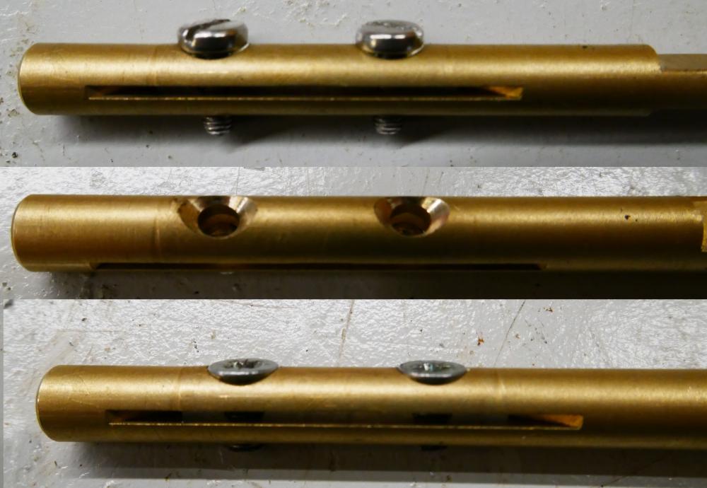

Modify the spindle to take flat-head, countersunk screws - and then file the edges down. Here's one I did earlier...
(05-05-2021, 11:32 PM)Tony Griffiths Wrote: Modify the spindle to take flat-head, countersunk screws - and then file the edges down. Here's one I did earlier...
Thanks Tony
I’ve countersunk the holes, filed down the screw heads and cut off the tails. I will Loctite them in when finished. The spindle is only 1/4” so I didn’t want to go too wild with the countersinking.

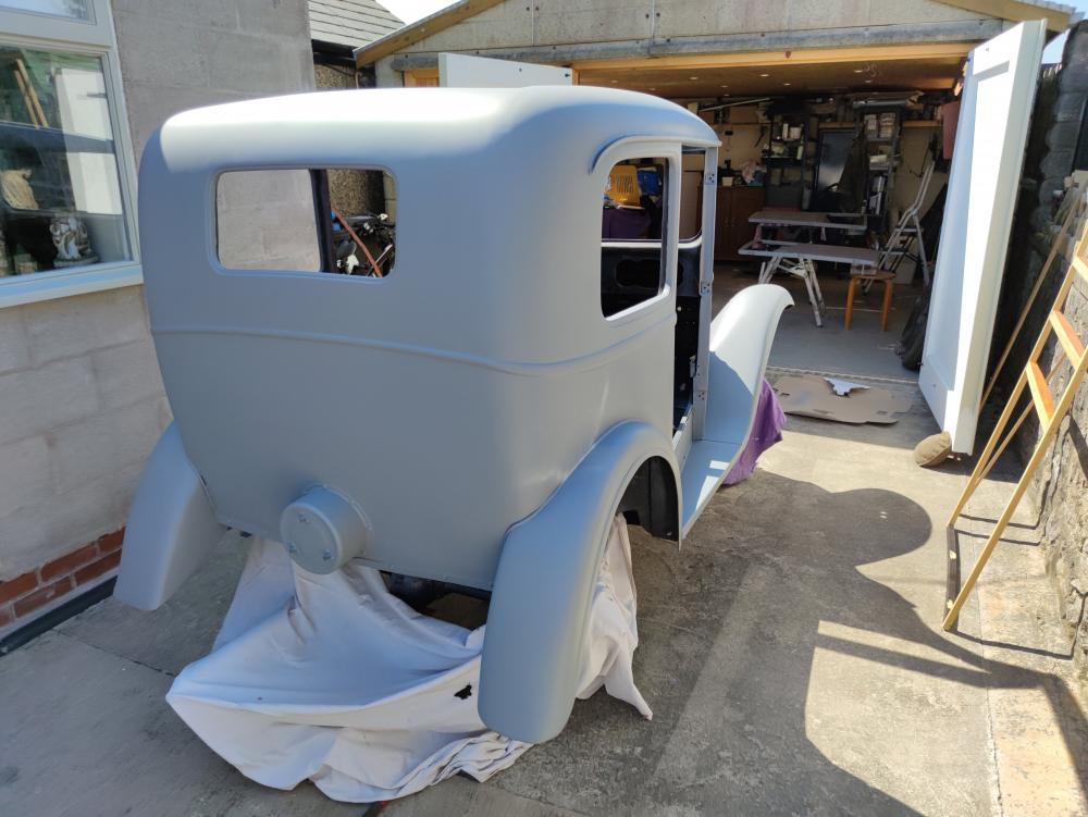

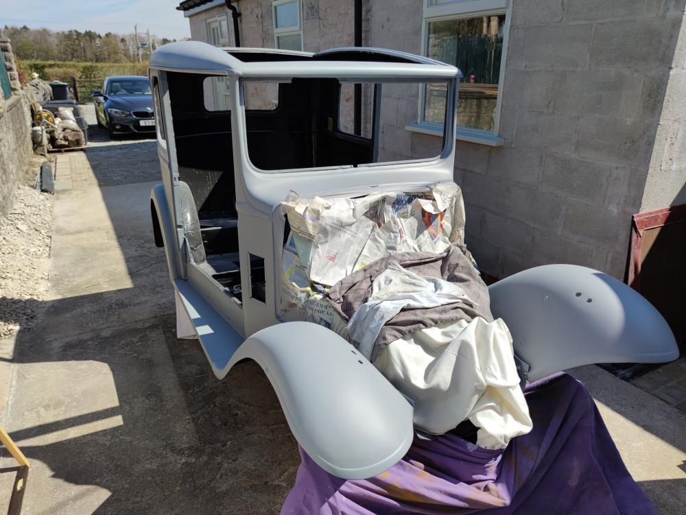

Hi all, my first post in this thread.  Thankfully lockdown has lifted enough for me to get back to my fathers to do more work on the Austin.  Finding a gap in the weather recently we managed to get the exterior primed in a high build cellulose primer.
After priming it, i immediately regretted not removing those beadings between the rear 3/4 panel and the arches.  They aren't fitted well and masking them will be a nightmare.  What to do????
All i can say is it looks fantastic in matt Grey!  I remember seeing and speaking to the owner of a beautiful grey model at Beaulieu a few years ago so it immediately sent me back.  I hope painting it Blue doesn't make me start getting envious!
From what I can see it looks good. When I had my Ruby re sprayed a few years ago I removed the front and rear wings together with the running boards. This made things easier and there was no need to mask up as these were to be pained a different colour.
