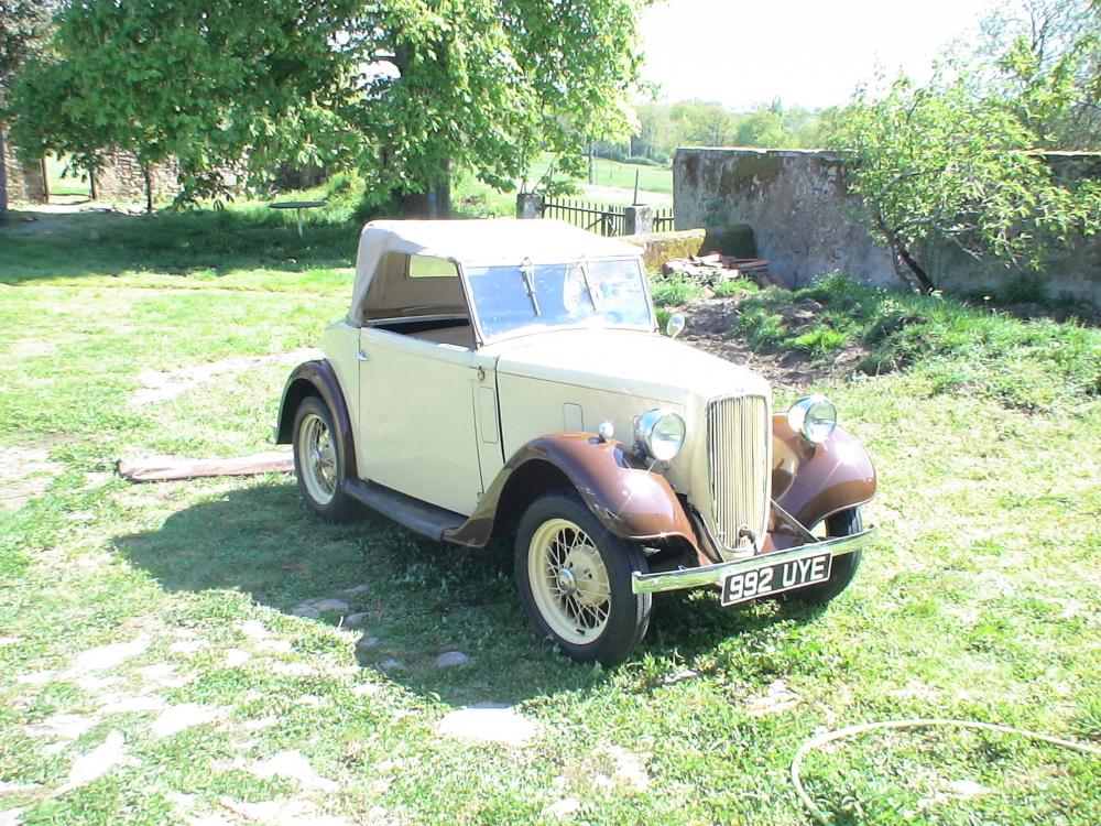

Got out our LHD 2 seater/Opal (still not sure which) after a seemingly long winter/slow spring. Started readily and we put the hood up for the very first time in our ownership. Bit of trepidation here because of the non original windscreen (a rakish sloping job) and not sure if hood would fit -which it thankfully did. Looks OK to me.
Now to check it over in preparation for its first CT (French MOT) so we can get it registered on French plates. Charlie.
Lovely little car! Where are you in France? And do you pass a CT in british plates?
