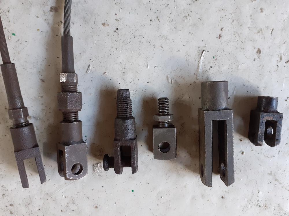

Not so much an opportunity as a replacement of what has been gradually lost from spec over the years, like 3 speed pattern clutch toggle levers. Here are some early adjustables, along with some of the bits which I wonder could be used to create an adjuster.

I've bought some M6 turnbuckles (4.50 each - cheaper than an Austin 7 adjuster!) to see if they can be safely drilled out to 5/16 to allow this sort of arrangement, which draws on some of the findings/ideas of other thread contributors. Using M8 would fit straight but they are heavier, more expensive - and possibly have too much adjustment. Creating wire rope loops seems an unnecessary hassle when you can get the right ends to suit what is there already. Another advantage is this will successfully allow re-use of adjustable SWB cables which have become too short as a result of fraying ends. Any thoughts on problems, or further improvements before I try and assemble as per diagram?
Gary Edwards has also ordered some non-swage connectors (they have a central steel "plug" which one places over the central metal core of the wire rope and then bends the outer wires over to create a joint potentially stronger than the swaged ones) which will make an even more finessed result without having to integrate the current adjustable cable point, which is probably the weakest part of the cable. It would also allow you to reuse non-adjustable cables which have been inspected for corrosion and breakages of wire threads.
