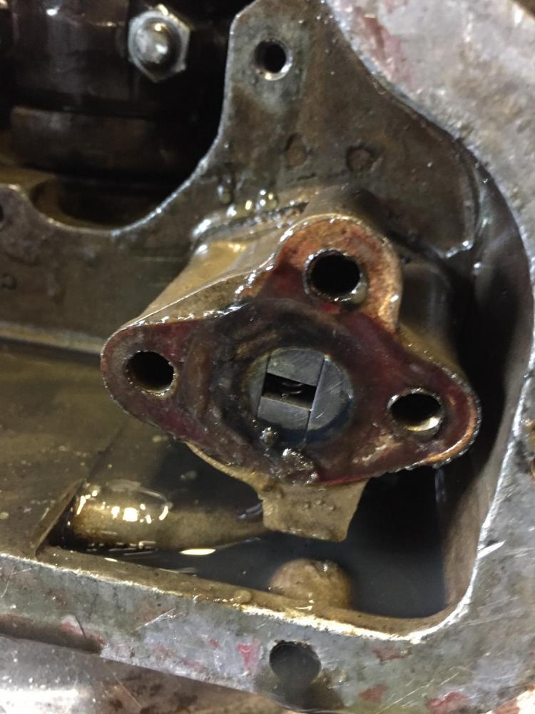

I'm looking for some advice and help. I've come to star my enginefor the first time with the car in my possession and I don't get any oil pressure when cranking, I've also removed the pressure tapping on the crank case and don't get any flow.
The the is on 12v with a 6v starter so cranks quite quickly.
I've had the sump off and all looks OK, pump drive etc.
Would I expect oil pressure or flow at cranking?
I've not yet inspected the pressure relief valve, are these known to stick open?
It's an early coil engine
Any suggestions / advice?
Thanks Neil

Thanks for the advice. I've got it fixed.
The cause was a number of these,
One oil pump vane in upside down which looks like it damaged the cover plate of the oil pump and a bit of the brass dwarf then jammed one of the oil pump vanes in the compressed position, I think it was the one in upside down.
Vanes and springs swapped for a spare set.
Cover lapped to remove the damage.
Swarf removed from oil pump.
Checked for oil at the jet access plugs - all ok.
I now have oil pressure on the starter.
Just need to get the down draft Zenith and ignition timing sorted so it will run for more that a couple of seconds.
Thanks Neil

The cause of the wrongly-placed oil pump gasket could well be because of the highly misleading illustration in Austin's Lists of Spare Parts, which show the gasket between the cover and the body. These illustrations are not like a modern exploded diagram, but it's all too easy to assume that illustration shows how it should be assembled, especially if you're not familiar with how the engine should go together.
