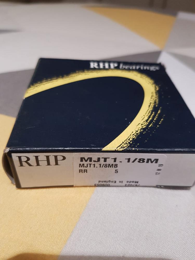

Could I ask what manufacturer the bearing are you bought.
Thanks tony.
Thanks for all the great replies, I was under the impression that if I got a set no further fettling would be needed.
Guess I need to have a look for some shims, the mini suggestion returns a few on Google so will look into that.
Tony- they were RHP MJT1.1/8M. They came 2 to a "set".
I've attached a picture of the box.
