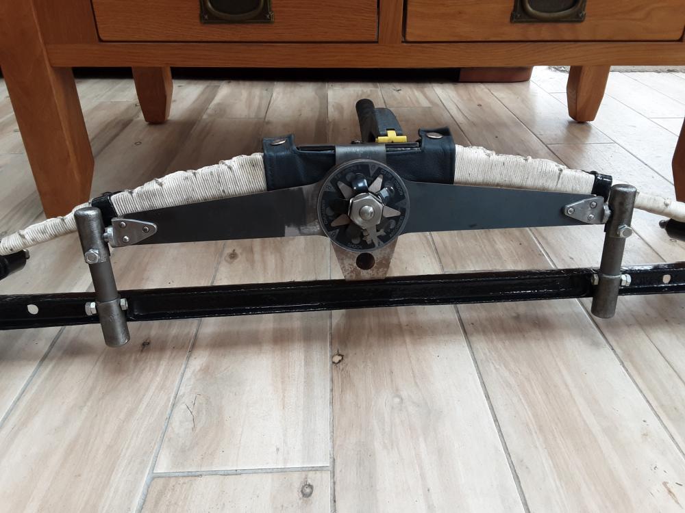

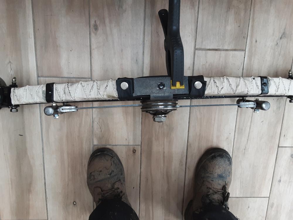

#24
Hi colin,
Here is as close to an original Hartford I've got.
I've replaced the main plate as the original had been cut and adapted to fit a later chassis.
A close up of the end brackets.
Here is a problem often suttered by sole traders.
There are alot of different parts to be sourced, press, weld, rivet, machine, heat treat. Etc etc. To make something like a complete set of hartfords. So they never get finished, as you also have to earn a wage at the same time.
So like this picture, you can fall to the problem of having half finished projects. Sad

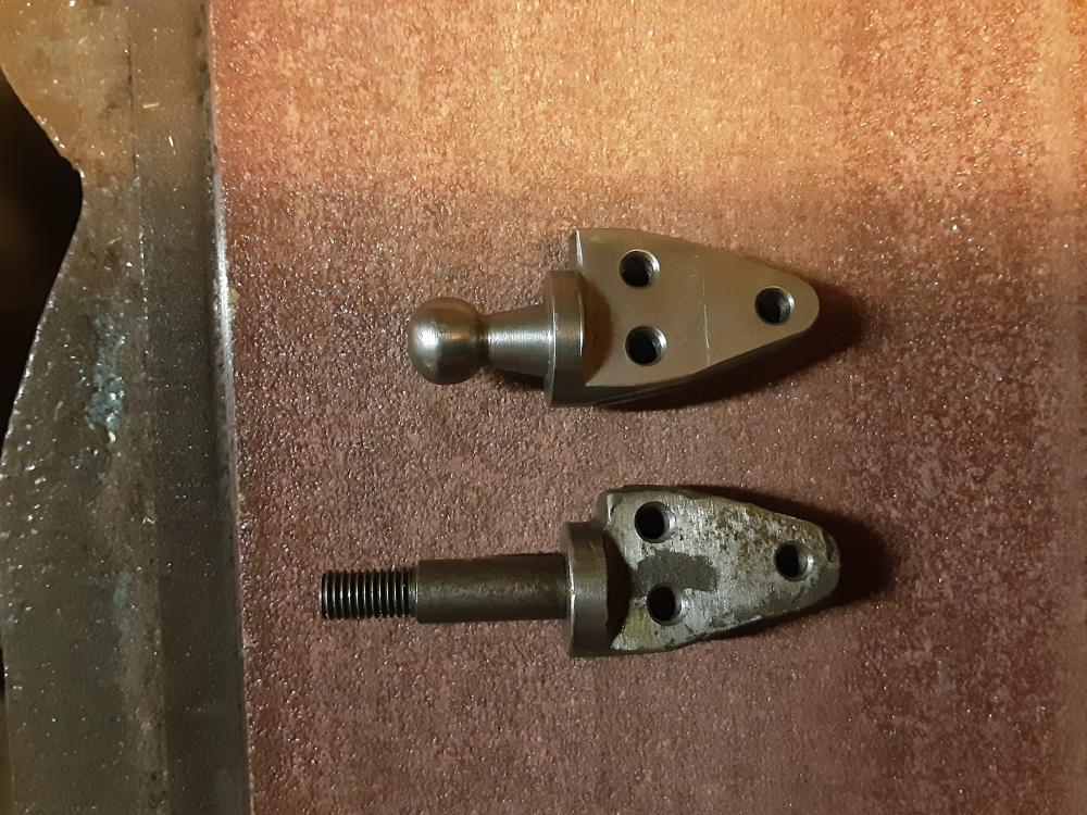

#27
Well, a few slow and to cold weeks.
But the friday, a few parts came back from a friends workshop.
What can I say, his CNC machines do a better job. And he is cheap.
So this morning, I've riveted etc. And the front dampers are now finished.
Just have to get them painted up this afternoon. Before it gets to cold again.
This is the new ball end next to the standard hartford.
This is how they looked on the original car.
The typical way I work, not wanting to pay for things twice.
And it costs very little extra to make something twice, once you are set up.
So I have had a second pair of the end rods made 1/2inch shorter, just in case i have to go to flatter springs.
Tony.

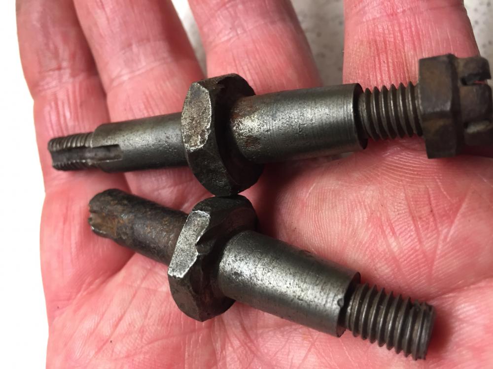

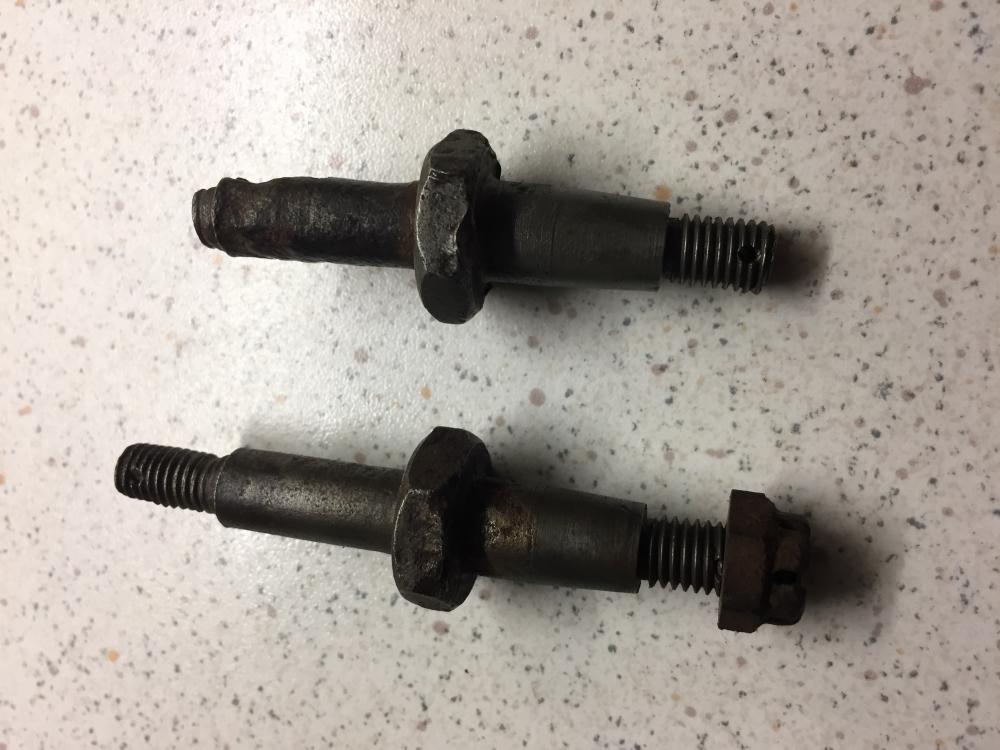

After a couple of weeks of from this build, to damn cold in the shed.
This week warmed up a bit, so I got back onto the chassis.
Pic below, bring forward the problem I had from the hartford thread.
The previous owner made the holes bigger to fit these brass spacers for the friction discs.
This pic shows the oversized hole against the peg bolt.
I've welded the holes, and after ALOT of filing.
The holes are back to size.
